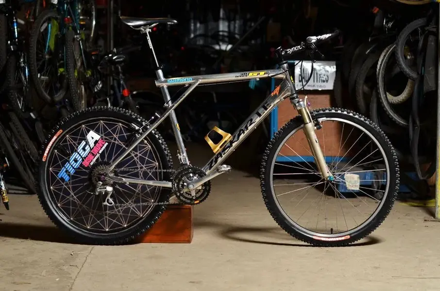

this is a 20 inch zaskar, in other words, this is a barn gate :P
six foot wouldnt be tall enough to ride one of these, thats only 3 inches taller than me and if i rode that i would need a step ladder to climb on it and my feet wouldnt reach the floor !!
as for older GTs in 19" they are very thin to the ground so lets not confuse matters :wink:
sean
