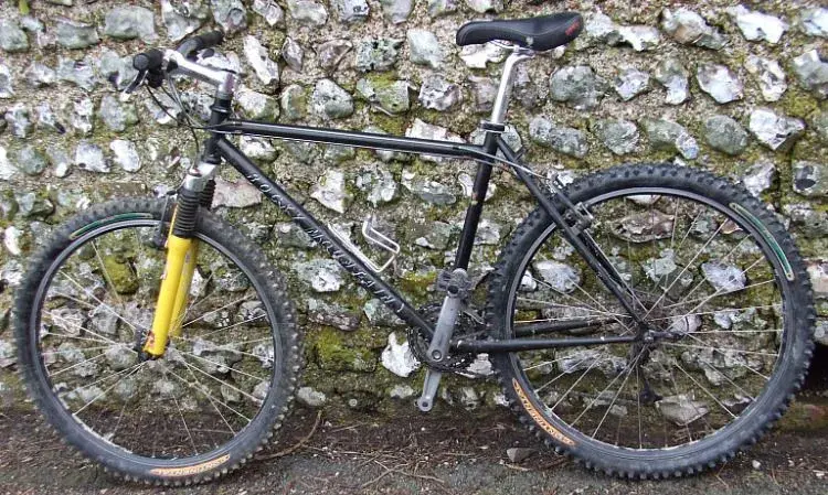

This one is from 1993, but with non-standard decals, the standard ones being green. It is made from Tange Prestige Ultimate Ultralight, which was one of the highest grades of Prestige at that time.
