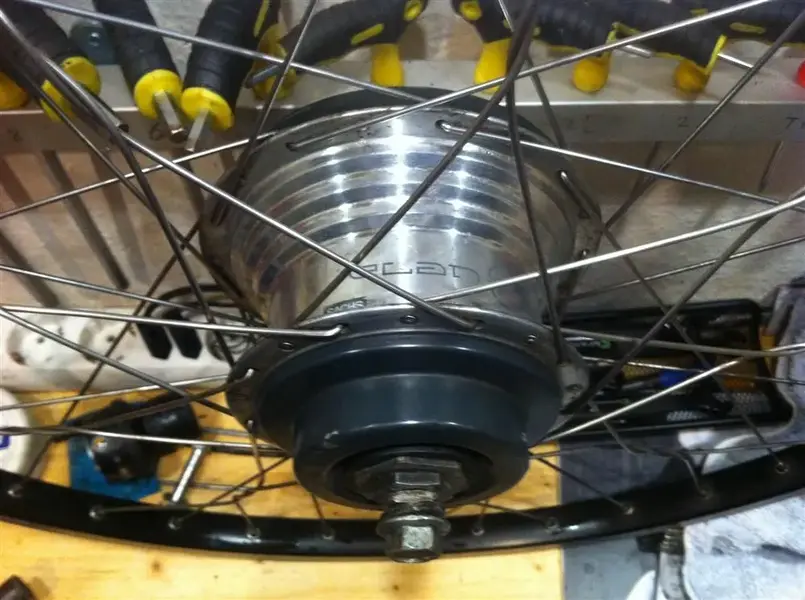

Thought I had some pics on my computer, but I don't so have to add the pictures later on. Here some impressions for now:
I'm out if it helps at all - a real unicorn part just came up for me.
I have Sachs other experiment in this direction on my folder - a three speed hub with attached 7 speed freehub and it works quite well.

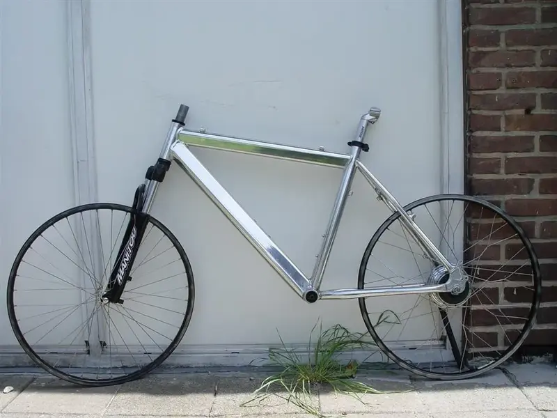

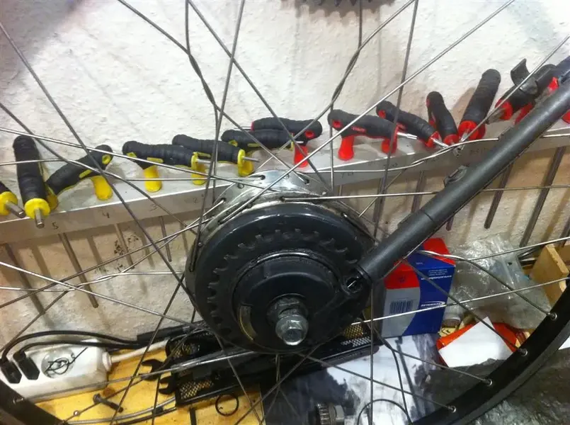

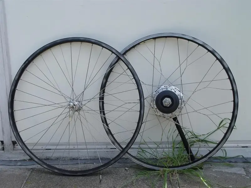

So here are the photos, sorry for the quality; late night photos in the man-cave. The picture with the bike is from my archive
from 10y ago; it shows the spoke pattern.
If I were to cut the hub out of the rim I could give it a good polish, If you want the complete wheel it is as in the photos; dirty.
oh btw the rim is Alesa not Rigida (well not yet, company wasn't bought by Rigida till 2001)
iscervo has first dib, bonkersbuilder second. Postage to UK will be 22-25 pounds because the package will probably exceed the 5kg everything together.

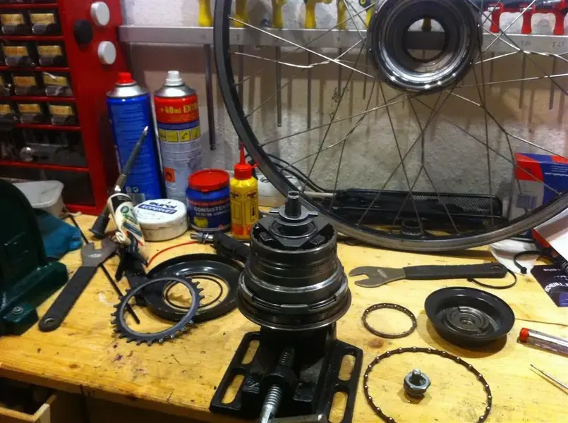

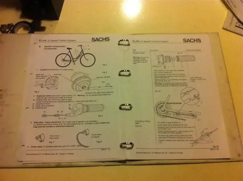

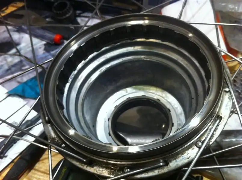

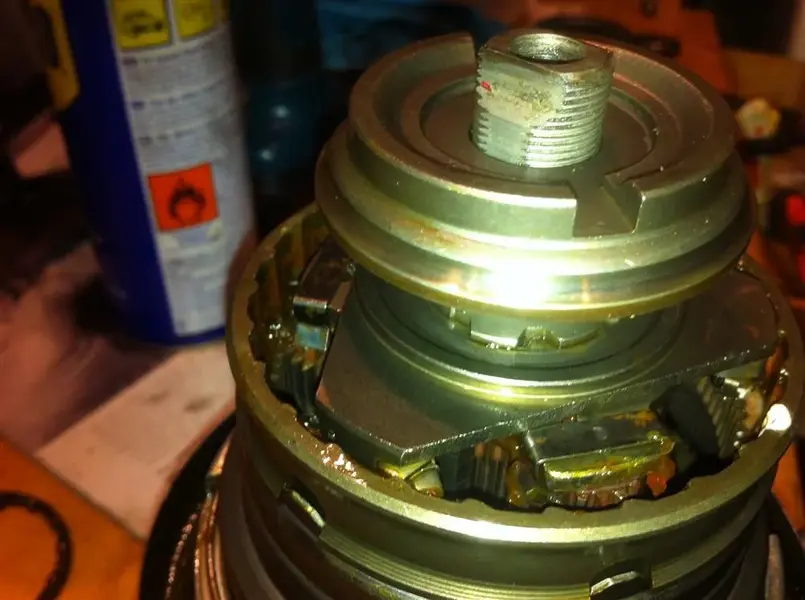

First I just wanted to sell this without spending too much time hassling, butI just couldn't resist to have a look inside.
With all the technical documentation it was very easy to open it up and have a peak.
On the inside it was exactly as I hoped, nice and clean, no debris and no metal from wear and no rust; so that's all perfect.
But yes, also as expected after 10 years; the original grease had turned a bit hard. So I took out some of the old grease
(I didn't strip the whole planetary gear system) dissolved the rest of the old grease with lighter oil and put in some fresh
grease at the gears. The bearing races were also covered in sticky hard old grease, but luckily after cleaning it revealed
nice smooth races without dimples. Oiled all the other pawls and parts.
Either I kind of spoiled all the resurrecting-fun for the next owner or I saved him a lot of hassle and time, it is up to you
to decide. Either way at least now I can say with certainty that it will leave here in good running order.
