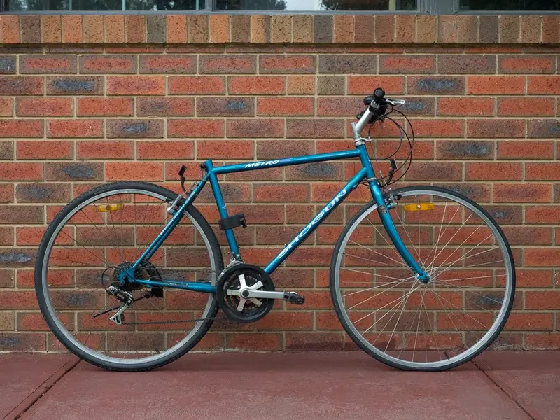

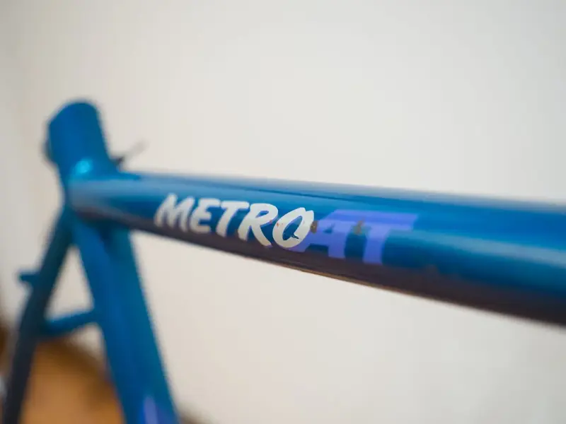

I present to you my latest find, a Shogun Metro AT, sourced from hard rubbish. If I've done my homework correctly on the serial number, I believe it to be a Sept. 1996 build, suggesting it was offered for 1997. (Happy to be corrected on this!)

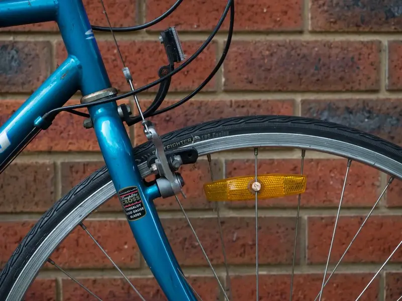

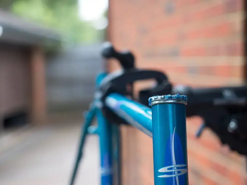

This dorky hybrid is a classic example of what was being turned out, en-mass, to the Dads of the world; 700c, cantilever brakes, utilitarian 3x7 gearing, single-wall alloy rims on serviceable Shimano hubs. I’m happy to report it looks well used with a healthy scattering of scratches and paint chips, so it probably has some stories to share. The one real bummer however is the absence of a seatpost (which I believe is 26.8mm).

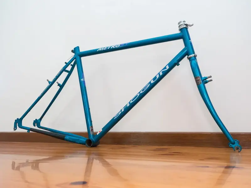

Frame stripped, rust converter applied to exposed metal and paint given a good polish. It came up a treat!
Let the re-assembly commence.

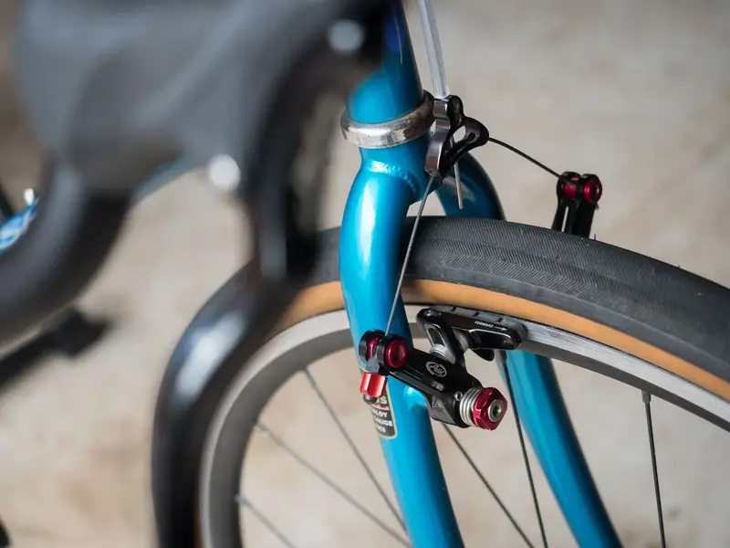

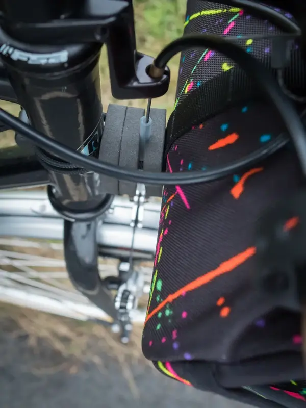

The front brake took me a little while to sort as the brake cartridge+pad, even in the lowest possible setting, were contacting the tyre sidewall. It's been reported that cantilever geometry in more contemporary brake designs places the pad higher above the post than in earlier designs; I'm assuming that's the case here though the rear brake seems fine with the factory spacer configuration.
In the end I stuck with the Avids and enlarged the holes on a spare set of (narrower) spacers to allow them to fit cartidge post; this allowed me to drop them just that little bit lower for better contact with the rim (teaser below). I've tweaked the pad angle since taking this photo but otherwise they're done!
Eagle-eyed viewers will note the little clear bit of tubing between the cable stop and the yoke; this is a 'sleeve' so that my bar bag doesn't interfere with my front brake (as set up below on my 'daily').

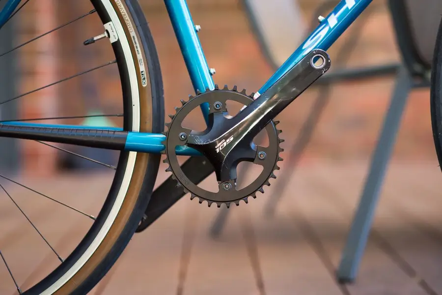

A key component has entered the chat: narrow-wide chainring.
Truth be told, I would have loved to have fitted a wide-range double but the parts bin was somewhat lacking in supporting components (namely, a shifter and appropriate rings), so this slightly battered FC-5800 crankset will have to do.
Also, I want this bike to look like what we accept as the industry tells us is a 'modern gravel bike', so 1x fits that brief.
This chainring features a 110BCD but as you'll see, also has Shimano's assymetric 4-bolt arrangement. This was a common pairing in the CX crowd running these cranks, at least before dedicated 1x cranks were a thing so I was happy to find a suitable chainring. The flat ring looks a little silly mounted on the thick body of the spider so longer term, I'm going to try and get my hands on the bolt covers made by Specialities TA to tidy this up some time down the track.

I'm curious looking at this build, your Marin is great and the basis of this build looks very nice
Although this is an intresting theme, but why even using one of the - to me - ugliest cranks the industry told us to accept as nice? Sure a lot of modern Gravel bikes, especially the cheap ones do have ugly crank sets. Just this one ranks quite at the top.
Theme-wise, as said, this fits.
