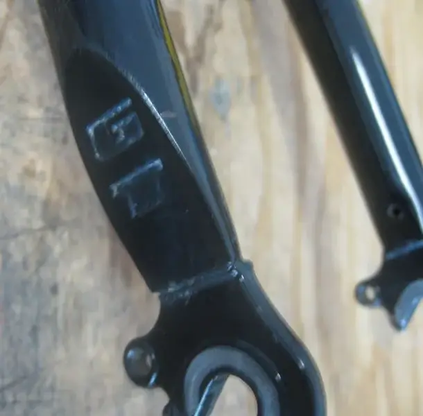

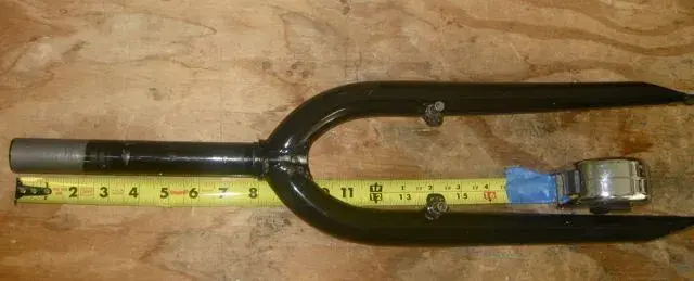

I bought this GT fork which I hope to use.
Do you think this woukd work on both the 16.5 0r the 18?

Those forks you have will be perfect, steerer on my bike is 7.5 inches so at 8" those forks will work with some spacers or trim the tube down slightly.

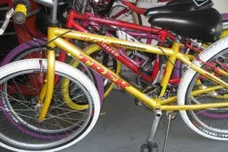

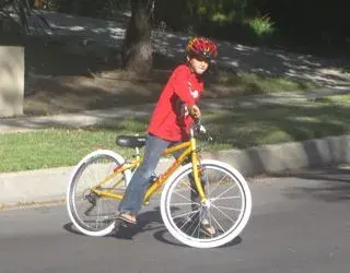

I found some sweet 18 incher's but I might like the idea of the 16 also. I'm looking to set this up with cruiser tires, and run it as a retro-urban street machine but trail riding is always a possibility. Size on the road seems not as critical as with off road use, but a smaller and better-handling more nimble bike would be cool. My 8 & 9 year old kids both love old-school bikes as well and the smaller size would put them on it sooner. (Please refer to our partial resto of vintage 24 inchers)
