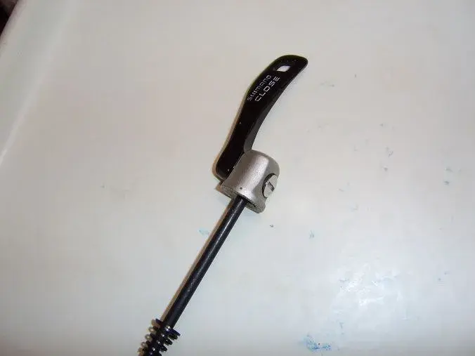

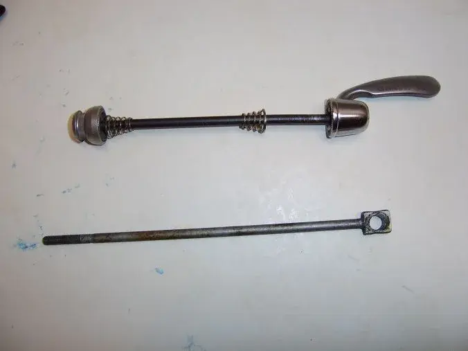

Somehow ended up with 3 rear m900 skewers and one front for my two wheelsets. Decided to cheat a little and make a front from the rear.
A lot of shimano skewers are basically the same, save for the grade of materials and the ends.
I had this orphan LX front sitting in the parts so it is going to donate the shaft. I believe you should be able to unscrew this type lever, but it requires heating first due to loctite. I didn't feel like messing with the torch so I just cut the lever off with a rotary tool :?

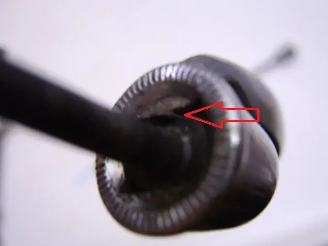

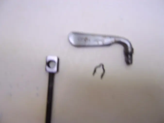

The 900 skewer and others including the same generation XT's have a tiney clip that retains the lever .....
Since the LX lever was fastened on the outside, instead of with a clip, the head was a little wider. I ran it up the grinder a few secs and made it just narrow enough to get the clip on .....
Replace the opposite end and now I've got my cheater front ......... Not original spec, but it'll get the job done.
