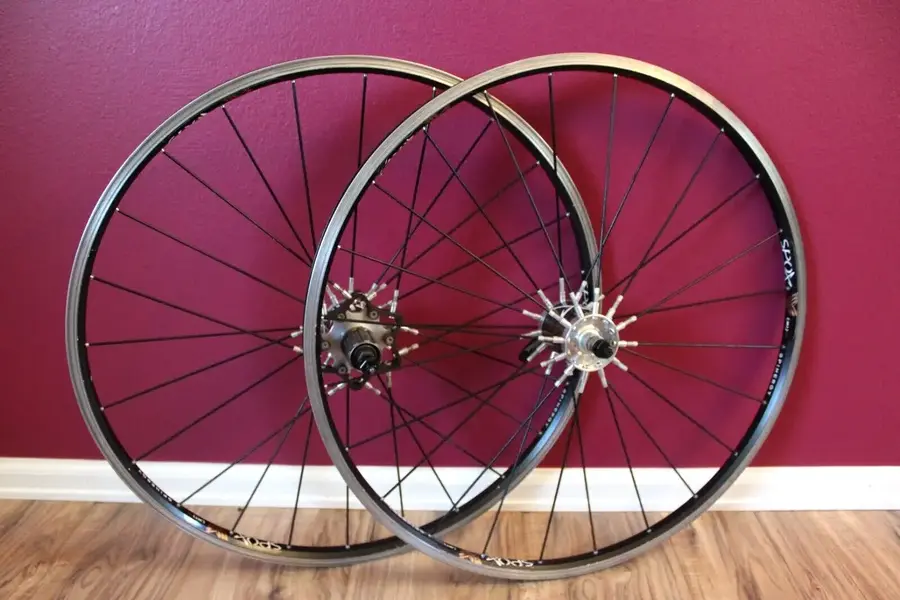

Pro's and cons of these wheels? Flanges blowing out, spokes hard to source etc? Truing would need specific tool too I'm guessing..
Any words of wisdom?

Rims look a little worn though, if you're buying them remotely, get a close up! Then you'd need to check if you can get a matching one/pair of you wanted to use them much.
Rears tend to wear 2x speed of fronts
Nice wheels imo. That rear rim looks pretty worn though. Not sure what rims are compatible but I'm sure they must exist. I've got a couple of pairs of the cyclones which are the newer equivalent. Great wheels, look lovely too. Spokes can be hard to get but not impossible. I've got a full set of front and rear spares in black and a few in yellow. The latter I got from danson on here for a very good price so worth contacting him if you need any. He may be able to advise on rims too.

I love them, have 3 or 4 old SPOX pairs on the go, and some more modern 26" Xyclones, QR with discs.
The spokes are pretty tough, and are rarely the problem. The rims do wear like any rim, (although some are ceramic coated), usual downfall is bearings and freehub, but they are serviceable.
I think he old rims are re-badged Sun Metals CR-18s, but you'd need a 24 spoke one for that pair. Not unknown, but pretty rare. Later models switched to 28/32 spokes.
I've salvaged replacement rims from surviving front wheels in the past. Several Mavic and Velocity rims are a similar profile, so could be substituted. The spokes do have a decent adjustable range if the rim's slightly different height.

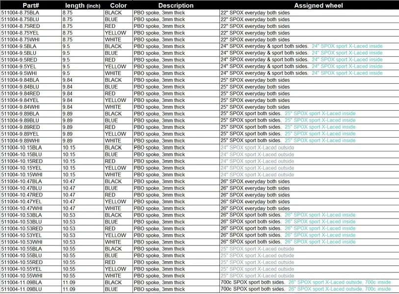

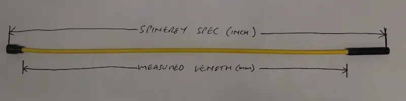

Length is measured overall, end-to-end. This was the 2018 offering with part numbers:
They are more fiddly than standard spokes and nipples since the spoke needs to be held firm at the hub against twisting while the nipple is turned. OK for just truing, but a PITA for building up with a new rim.
The details of the nipples, and required spoke keys varied a little over the years, but I certainly have these to lend if you need, and duplicates of most. Most commonly, you'll need one small spline key and a hex spanner, or on older wheels, two spline keys (one large, one small spline).

Yep, I raced a set of these in the Alps in the late 90s and blew the rims out on a long descent when they overheated. Very light and look great but like a lot of trick stuff just not up to long term abuse.
