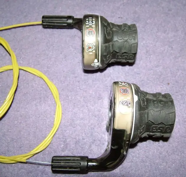

Skeelsie Gold Trader Feedback View Jan 1, 2010 #1 Are the below shifters (circa 1997) marked ESP 900-11 and ESP 900-81, 24sp, compatible with Shimano mechs? Do they have 1:1 pull ratio, has anyone has sucess with them on Shimano groupo's? Cheers. Attachments SRAM-ESP900.webp 76.5 KB · Views: 1,431

C cce Retrobike Rider Gold Trader Feedback View Jan 1, 2010 #2 ESP stuff is 1:1. it wont work with shimano.
Xesh Senior Retro Guru Feedback View Jan 3, 2010 #4 cce":3ru4wlt9 said: ESP stuff is 1:1. it wont work with shimano. Click to expand... Wot he said. I used to have some of those Venhill cables on my bike bitd (I couldn't afford the likes of Ride-On at the time).
