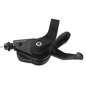

Did Shimano ever make 7sp STX shifter units without indicator windows that were separate from the brake levers or am I imagining things?
I remember something like that but can't find any evidence...maybe it was Alivio? I'm sure something very much like a MC40 shifter with no indicator existed.
Bit of googling reveals they were the SL-MC37
7 & 8spd without windows with grey mounts, black mounts, silver mounts. I used to get at least 2-3 pairs a week via the tip or car-boot sales. Now they have all but vanished.
*EDIT
Knew I wasnt going mad: MC-38 8spd
bicycle-shimano-stx-rc-mc38-rapidfire-rear-shifter-8-speed-30-leslie-sheppard_6455448.jpg
MC-40 7spd
Bam! Thats the ones. Were quite popular with people who had midrange bikes and were upgrading their brakes (e.g. to Magura or Vs) but keeping their old 7/8 speed drivetrain.
Also the STX-RC 8 speed ones are MC38.
Can buy both NOS for quite reasonable amounts of money and they work pretty well for what they are...I wouldn't get 2nd hand ones as they do get sloppy in their dotage.
