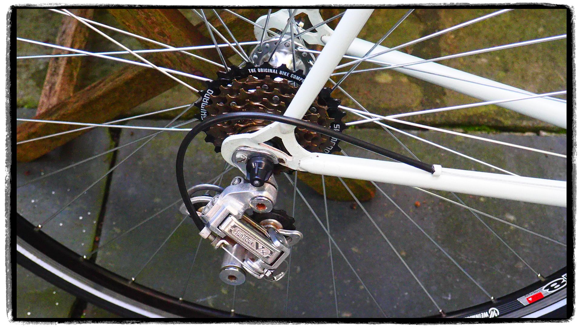

Hi all,
I've just bought a Claud Butler Majestic as a winter commuting hack and I'm currently servicing it before riding it.....
I noticed the rear derailleur was slack on the frame and as I undid the bolt it was clear that the derailleur body wasn't rotating around the bolt (it was quite an effort to get the bolt undone!)
Looks like a GT version of the Vx mech
Anyway - it's off and the pivot bolt is now loose but am I missing something? I can't see a way of this rotating when fully tightened - it looks like the pivot bolt will just nip the body of the mech up against the frame......

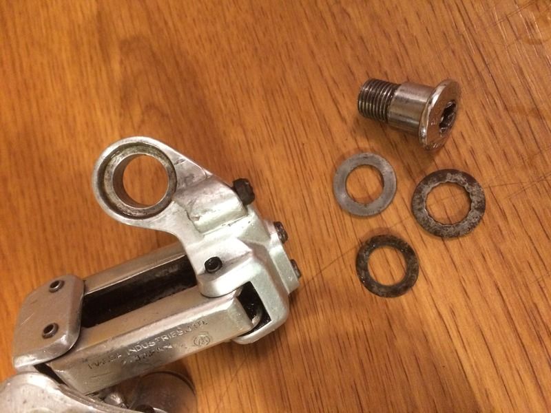

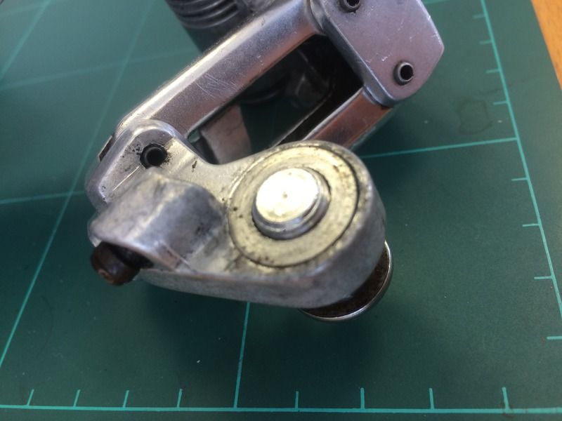

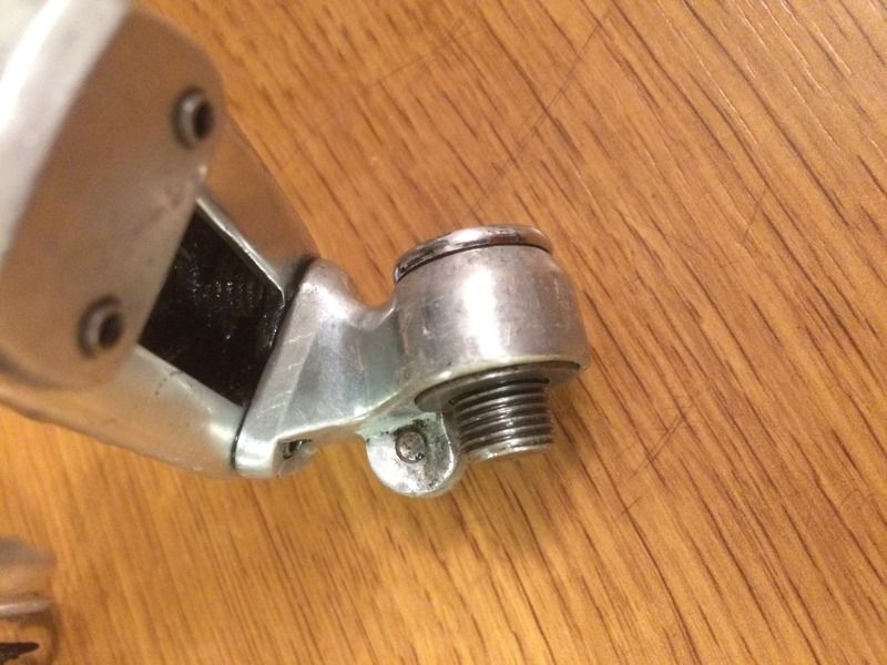

Fixed it! Decided to investigate further and tapped out what I thought was a steel insert which turned out to be 2 washers and a shim. The fact I had to tap them out was a clue as to why it locks up solid - as these should be free to rotate. This "stack" of washers sits slightly proud of the body so when the bolt is tightened up it bottoms out on the washers allowing the mech body to rotate freely around the bolt.
I think this is an early Vx mech as all the reference images I've seen have a locknut arrangement instead of the washers.

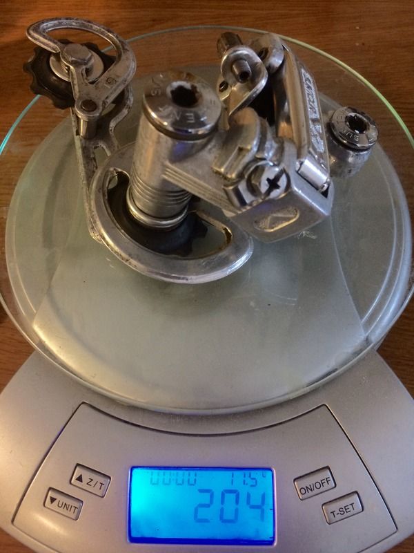

And for reference.....it's 200g give or take (catalogue suggests 210g):
