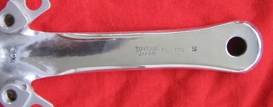

Is there a difference between the XC Pro and Comp cranksets? I polished one awhile back and removed the decals, now I can't remember what I have. :oops: Here's a shot of the back before I gave them a final polish.
Any input would be greatly appreciated.

Pretty sure those are XC Pros, but to answer your original question, the big difference (I think) was really just the chain rings. Both were cold forged.
Great cranks--they seem very similar to M900.

These are the original one before they went MD you can tell by the distance of the arms to the crank arm, so the profiling isn't a low as the M900.
EDIT in fact these are manufactured end of 1989 from the date code stamped on them.
Would have come with black rings in 1990 model year, have cost £100 RRP XC-Comp £15 less than that.
I think they used a 121.5mm bottom bracket though with more length on the drive side than none drive.
(think 127mm if a symmetric bottom bracket is used)
Agreed, they are nice cranks, they were not perfect to start with, but polished up very well-the clearcoat was seriously tough! It took a bit of work to remove. More great info, thanks everyone.

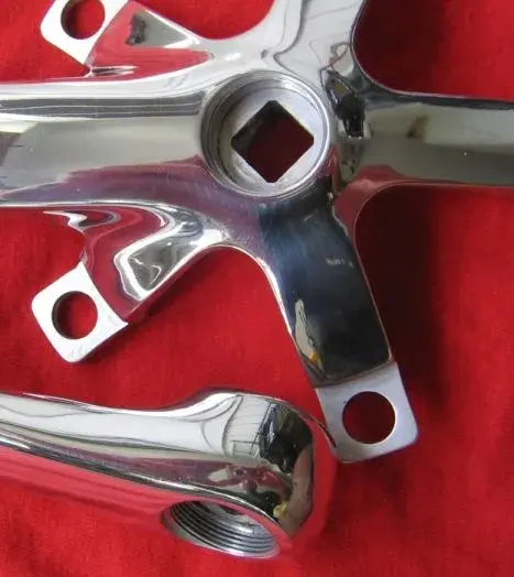

fairly sure the XC Pros are drop-forged, where as the XC Comps were the usual forging (castings) or something like that – pretty sure there was a difference in the way they were constructed that favoured the Pros anyway.
Pros are beautifully finished too
Comps in MD format (guess at impression forged by SR Suntour) are heavier by quite a bit iirc than Pro's in MD format (cold forged by Sugino).
Rings are the same but Pros are hard anodised (mid+top)
Not sure on the 1990 one's it just say Hi-duty forged ?
Would need to be made by Sugino to be cold forged iirc as Suntour didn't have the capabilities hence the above in the MD format.
