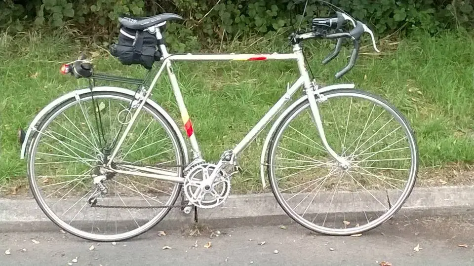

i have just finished re commissioning a Claud Butler Sierra which is 501 throughout and had the same thought so fitted a nice pair of sprint and tub rims and god forbid a set of Carbon drops and matching stem and its ended up being a great bike to ride and quite light as well
