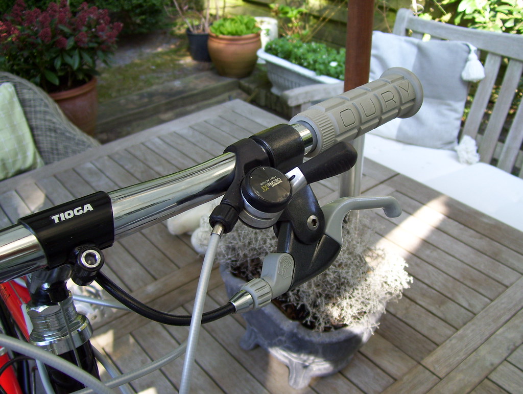

Alternatively use the old diameter outers. I remember that when I used a ferrule icw normal diameter outers the cable was pulled through the ferrule too under extreme force. They weren't the best ferrules, but with the old diameter cable (without ferrule) I had what I wanted.
Slightly larger diameter old outer >>>
