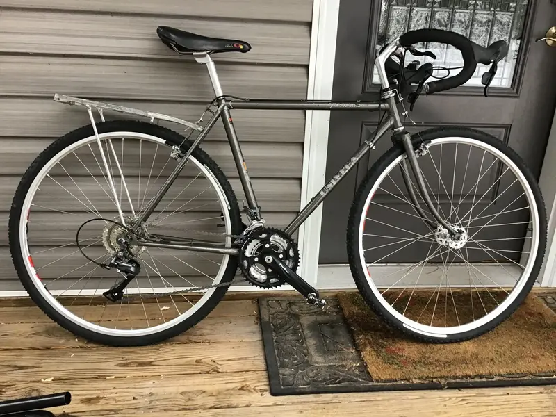

I use mine all the time. Road riding 100+ miles and gravel 80 miles. Mine is a straight gauge Univega chrome moly touring frame with triple heavy cheap chainrings that I added, 7 speed so no spread of the chain stays, canti brakes, 29er double walled hoops laced to a vintage front French hub and thread on rear hub. A modern cockpit with brake shifters and cross top brakes. it has 38 mm gravel kings that required chain stay dimpling. I really load this bike down for wilderness gravel riding and camping in the bush as straight gauge tubing can take a lot. I used rivet nuts to mount the bottle racks. It wasn’t finished in this photo. It now has the bottle mounts and a front rack. Its made from my parts stash so it’s got some vintage stuff on it but I have no problem keeping up or slowing down with the high dollar carbon gravel bikes. If it’s Univega it should be good. F4E4743E-CADC-47DC-936C-0175D1F49F6A.webp

I like that very much, my Univega is plain 4130, and am hoping one day to build it up. I did have an Alpine model which was nice but gave it away 😬
