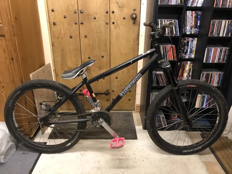

Thought I’d post this up here, just to keep a record of progress as much as anything..
I’m not sure what model this is, tbh don’t know much about this type of bike other than I’ve always fancied one ;)
I picked this up via Gumtree in need of work but at sensible money and it’s already yielded a nice X-lite top cap for my Cannondale so happy days.
Nice strong steel frame and 24” Deore/Sun wheels, unknown model Marzocchi fork (dirt jumper or similar - 2003).
Needs a general re-fresh and a couple of bits but the bones seem good..
Completely stripped, new bb bearings ordered and a 32mm seal kit for the forks, otherwise it’s just clean, lubricate and re-assemble.

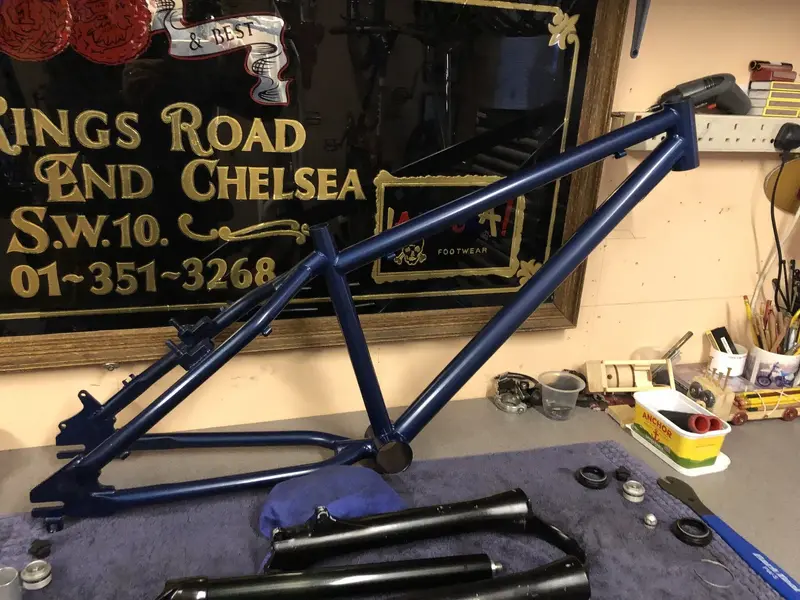

I was just going to blow the frame in with some black paint but I ended up changing the colour to this metallic blue (I had a couple of cans spare)..
New decals are here already so once they’re on I can lacquer and re-assemble.

Got the decals on and sprayed the frame with a couple of liberal coats of heavy duty lacquer. Hoping I can build this up next week once it’s dry, all the parts are here just a bit of cleaning and polishing to do really.

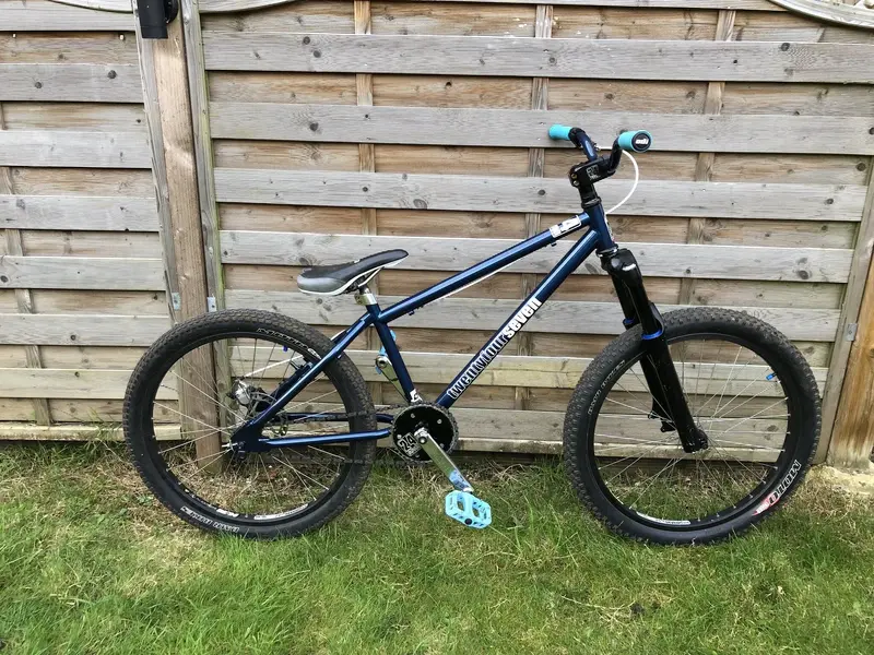

Got it all back together and looking pretty sweet.. new bearings for the bottom bracket were an education - never had to do Bmx style ones before, but they went in ok. The headset was missing its crown race but I found one that fitted. Rear hub/free hub service just basic tlc needed really.
Rides nice, like a giant Bmx.
