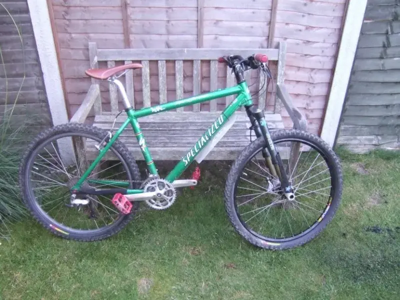

I've got Maverick sc32s on my Stumpy - they're lovely forks, light, stiff and a bargain of eBay, although with the added expense of needing a new front wheel built up due to the aforementioned thru axle hub and buying some disc brakes for the front, it wasn't such an amazing deal!!
They still only cost £262 including the hub though ( and you need a specific Maverick sized hub too because they've got their own 18mm (I think) axle) much better than the £550 ish from the shops.
Oh yes, and they look sweet too!
