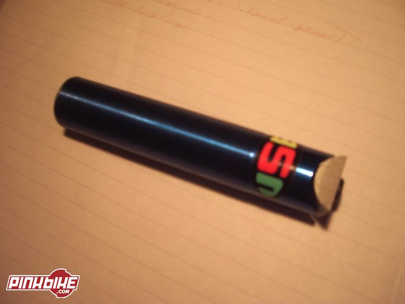

I was hoping to get some info about the USE bar-ends. They can't be installed like other normal ones but have to be tightened inside the handlebar.
Are there any special handlebars that I have to use for these bar ends or do I have to drill a hole in my sycros handlebar?

they came as part of a u.s.e. bar and handle combo when new........you could drill a different bar to use them but i would be carefull,the u.s.e. bar would be specifically tapered to strengthen the drilled area which wouldnt be the case with a syncros...how heavy are you and what use would you put it to?....any bar faliure could leave you in trouble!!!.......welcome to retrobike..... 8)

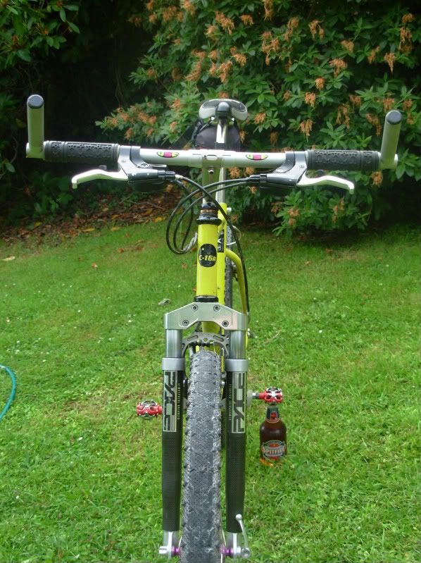

It's likely but they will be part of a build.....try a search.....possibly a catalogue scan in the relevant section too!.....photos of the Merlin required too!.... :wink:
This is the only photo I have at the moment:
You could possibly fix USE bar ends to other bars but as has been said before - need to be very careful with drilling holes............... :wink:
