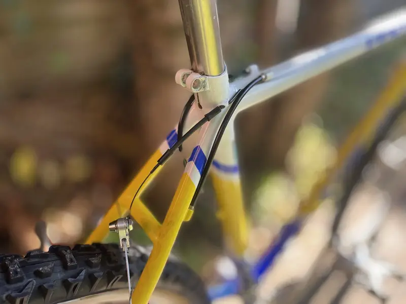

I installed an XTR chain rather than the KMC as the KMC looks too modern.
Also I follows advice and used an inner to thread the rear brake cable through this guide though tried to tidy it up using an outer extending towards the rear canti hanger

I'd remove that little piece of outer between the guide and the hanger personally, as it's not doing anything.
From that pic it looks like you could fit a standard recessed seatpost bolt, which would look spot on imo, unless you'd prefer a QR?
Thanks I’ll do that. I thought the outer would give it some stability but doesn’t make any difference

im after a bolt binder as no need for a QR as Seatpost doesn’t come off much
I believe it is there to catch the straddle cable in case of a failure, so you don't face plant...
Never thought of that!
I used it as I’m used to an arched canti hanger connecting the top two rear triangle tubes enabling the cable to be flush centre when connected to the free hanging hanger - this lacks that so the cable goes down at an angle giving it an odd appearance
I'm talking about the bit of outer cable at the rear brake
Plenty of bikes had the rear cantis pulling at an angle. It's not perfect but it is how they were designed. As you said you could trim the sleeve down just to protect the paint a bit though.
