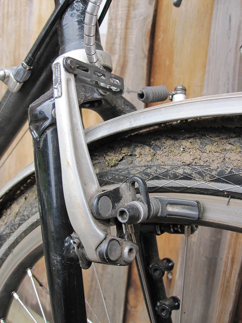

I'd go with Avids over XTR any time. They don't have the needless complexity of the parallel push mechanism which seems to do nothing other than add weight and cause screeching. SD25 is my favourite - it's very light too.
Overall Maguras win for ease of maintenance (none needed EVER) and braking performance.
Very early XT parallel push but turn the arms around they don't squeal.
Parallel push is vital to maintain perpendicular pad contact, otherwise they "arc" in and dive under the rims as they wear.

Some references to back up my brake claims:
reverse the pad holders on the front brake to prevent squeal.
https://forum.cyclinguk.org/viewtopic.php?f=5&t=84065&start=0
Sheldon's v brake notes https://www.sheldonbrown.com/canti-direct.html
And yet people have made canti brakes for almost a century without parallel push.
I agree that it's a refinement, the problem being in practice that there are 4-8 more wear points, and the linkages inevitably slacken. The diving problem is effectively designed-out by the thin pad.
If you like them, fair enough. To me they are typically Shimano: an over-complicated solution to a non-existent problem. Just like front indexing, dyna-drive pedals, Octalink...and a fair few more.
