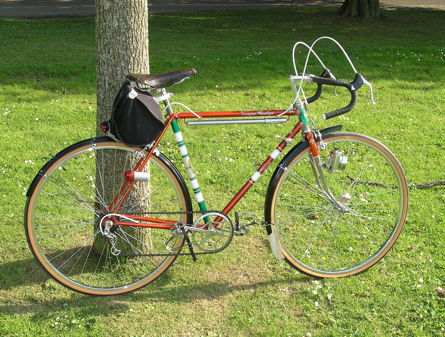

Here is my Carlton built Sun Snipe from the early 60s...
Lovely old marque worth preserving. Nothing spectacular or hi tech but good, solid and attractive British engineering...
