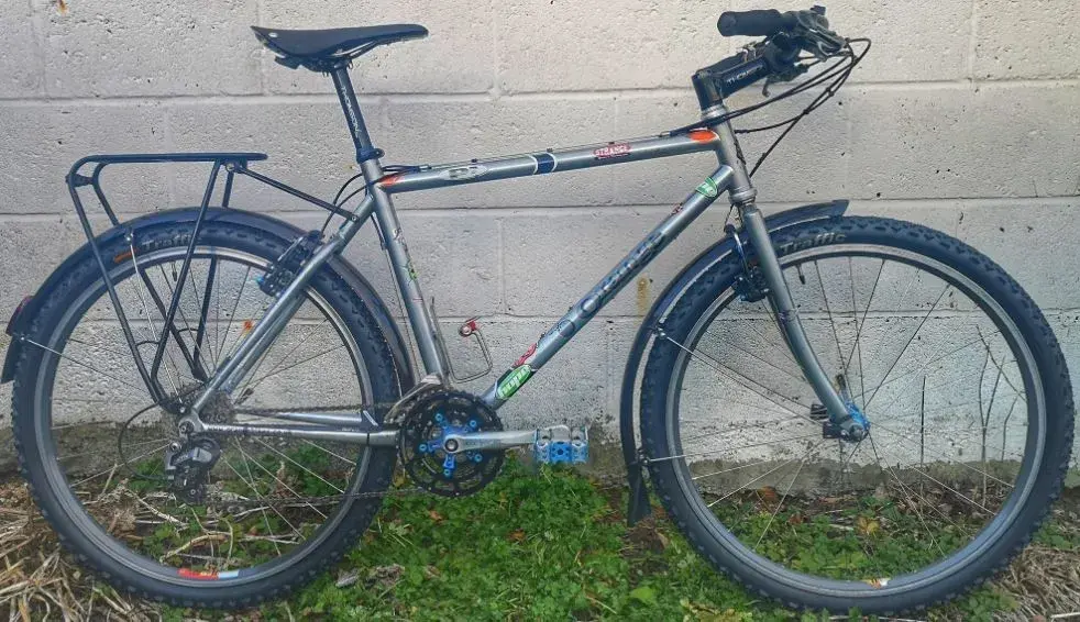

It's original. I'd keep it on. Mine's the following catalogue year with different decals (plus a few extra, some to cover marks!). Silver paint finish. Yours looks painted same rather than nickel plated same as mine.

Yours is 2000 but I've put 2000 & 2001 below plus 2000 components. They came with an Orange Fido stem & Hot Rod 2 bars but you could spec the Supercross 2 risers. Mine has neither as I've fitted Thomson stem & Ergotec Humpert Space Bugel bars which are better suited to it's purpose as a tourer/commuter for me.

Re the finish - never seen nickel this late & the pics do look like the same finish as mine - a very silver silver!

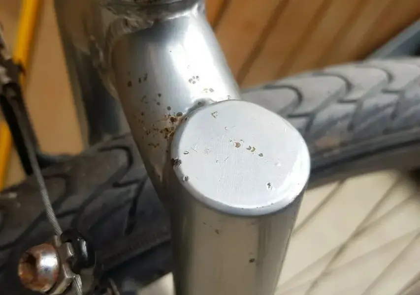

You are probably right about the finish - as I said I'm no expert. There are a few spots of rust and so I'm thinking of maybe powder coating it in the long term. Not sure about the availability of decals though?
