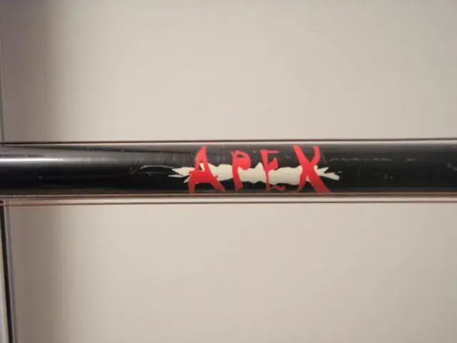

Hi Guys,
This site has inspired me. I have come across a diamondback apex that I want to restore. Can some one help me with the year and a few other questions.
-Im in Austalia (not sure if this makes a difference to the year)
-Frame color black
- frame says it was made in china
-TT-Lite True Temper Race Frame
-STX-RC back and front Derailleurs
-STX-RC back and front hubs
-Avenir double buttered 180g 1909 alloy handle bars
-Avenir handle bar grips
-Avenir seat post
-Shimano servo-wave action Bracket levers
-shimano v-brakes
-gear levers not sure what they are have only identifier on them is the number 85 or it maybe its a S8
-Straight forks
Everything I have listed above is original to the bike.
The only parts that are not original, see the attached photos, is the seat , tyres and the handle bar stem. Would it still be posible to get a original seat & handle bar stem for that year?
What does a TT lite frame mean? Would i be able to sand back to bare metel and clear coat it. What would the metel look like. I have no idea
Did these bikes come with front suspension. If so what should i get.
Cheers
Daz

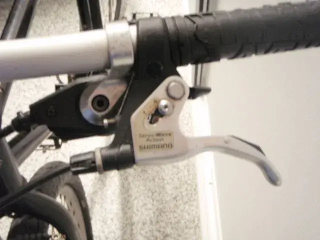

They look like STX-RC and the number is probably 8S, for 8-speed, as STX-RC could also be had as 7-speed. Good shifters, worth keeping.
Difficult and probably unnecessary - those are the kind of parts that are good to upgrade
TT Lite is True Temper's mid-level double butted cromoly steel tubeset. A good tubeset, only the heat-treated OX3 was higher.
Clear-coating doesn't really work for steel, because it will go brown under the clear coat - you really need to prime it and add whatever finish you prefer.
Yes, as an option. but I wouldn't fit a 1997 fork myself as it would have been an Indy, which aren't much good. If you can get your hands on a red Marzocchi Bomber Z2, I doubt if you would regret it.
Nice bike!
Any front bouncer will be longer than that rigid I reckon and won't look as good. Even the presumably only 63mm travel Indy in the catalogue lifts the front end beyond that with which the geometry looks right IMO.
Nevertheless, the frame was designed for a suspension fork, and only the cheaper options were sold with a rigid fork instead. Consequently the head angle we see in the photo with that short fork is in fact extremely steep, and they used to have to fit very long stems to deaden the steering down a bit. The sagged length of a Z2 or 97 Judy is about 3cm longer than that rigid fork, so should give perfect handling if combined with a stem of 11cm or so.
I don't dounbt that was sold as "suspended corrected" - I remain unconvinced that it was so designed! The jigs probably out-dated and simply overtaken by front end developments. Just doesn't LOOK right.
OTOH probably rides just as well if not better with short bounce.
