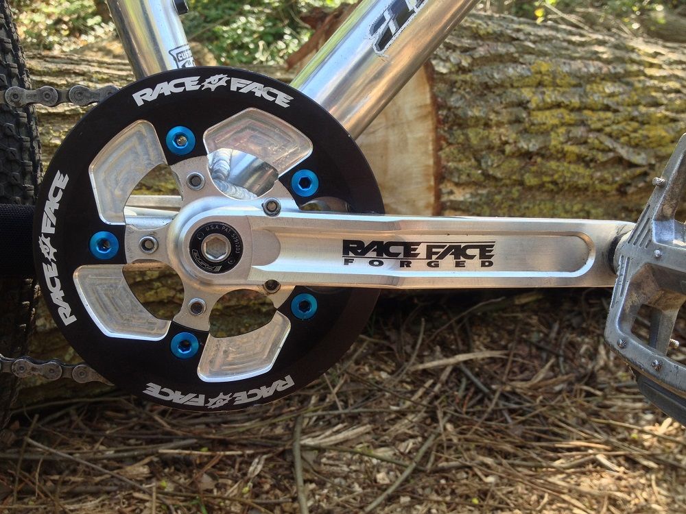

That's forged so it's a later set, mid to late 90s without looking in detail.

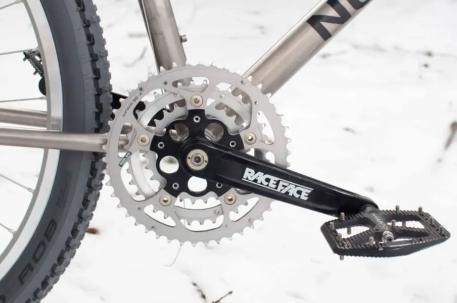

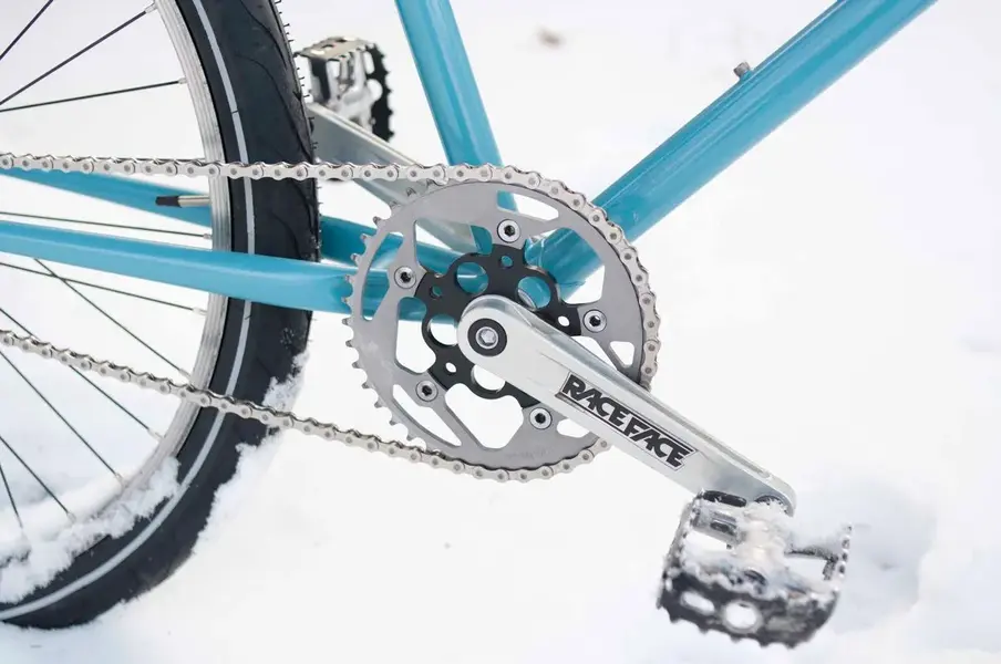

Here's a couple more examples of the first ones off the line...
No they are IB (I-Beam) not LP (Low Profile). Both are different lines and ran side by side once the LP was introduced a year after the IB hit the market.
Both are Turbines of course, both came in Compact and Standard once introduced too.
IBs also had a road version too.
I have 2 different versions of the LP's. One is similar to yours Sean, the other does not have through holes for the granny ring bolts.
The one without holes have a deeper front crank arm profiling and a rounder seperared style for the spindle centre rather than straight edged from the crank arms.
They're the ISIS era cranks (still with square taper too) so whenever they brought them out in the 00s given they where a pioneer of it.
