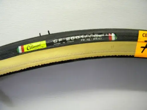

i rode on some clement 2001 Tubs back in the day which fitted clincher rims from memory
