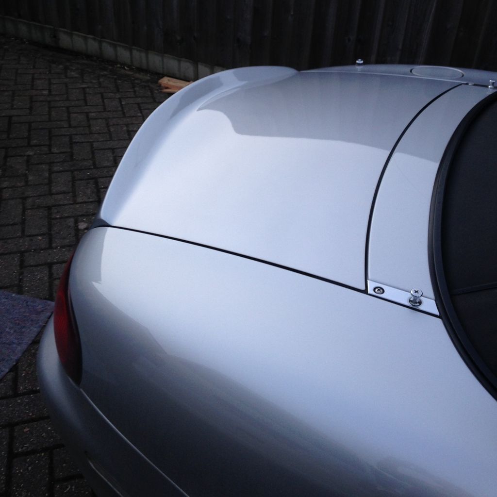

a finish like this is not hard;
And this boot lid was rattle canned too;
Search ebay for 'Nu Agane' they're a paint shop, very decent paint, and the do a bundle of primer, colour of your choice (just find the paint code you want) and 2K lacquer for £15!! proper paint, and a bargain price.
