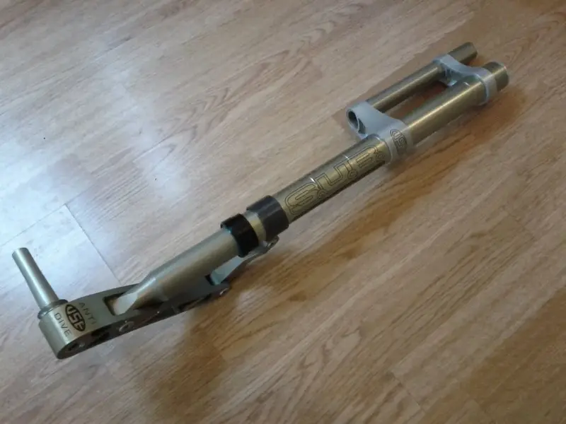

Is there any chance you could possibly post a pic of your LE axle that utilises the Hope hub? I ask as mine are champagne/gold with silver crowns and number 18
Which hope did they use, as I guess it would be bulb era and if so, did they do an adapter or was it a special hub developed for the fork?
Here's mine

Photos are in the link, the USE Goldtec hub will not fit on the LE stub as the smaller bearing i.d. is to small, there isn't any model type on the Hope hub, both bearings in it are 6804rs with outer one sleeved to fit the reduced diameter of the stub, the spacer tube between the bearings may also be different, I haven't compared the 2 side by so I can't be sure the tapers are also different. .

It's safe to say I have the LE fork as it is identical to yours, Your's being 3 and mine being 18, so at the very least that's 10% of all production owned by RB'ers, Sweet! 8)
Speaking to Hope, the guy who'd been there for 20+ years has no recollection of making a special hub for USE and suspects they just bought some standard hubs (Most likely Bulbs) and machined some end caps to make them bolt on to the stubs.
Called USE and the tech guy swears they have never used Hope hubs and there have only ever been two fitments being USE Sub hub and C'Dale lefty, However after explaining findings so far he's gone away to check with a definite uncertainty to his voice! But to be fair, being over a decade later and only 20 sets it could easily be forgotten.
So, from what I understand looking at your photo's, the hub shells appear to be the standard bulb, I've removed the 20mm spacers on a bulb hub I have next to me and the bearings are the same spec as yours, so the only difference is the allen key end cap, Is it the same cap as used on the sub hub by any chance?
Looking at the fit when I put the bulb without end caps onto the forks, it is nicely snug at the fork leg side with the 30mm ring on the axle sitting flush with the bearing, then the axle tapers to approx 16mm leaving a 2mm gap around the circumference and is approx 15mm shorter than the the hub shell, suggesting a fairly deep recessed bolt that not only bolts into the hollow axle but sleeves over the top also?
Would it be possible to get a pic of the bolt on your Hope please bud, Sorry to be a pain
Photos in the link. It looks as though its a standard Hope hub with specific fittings made by USE, so what you need to fit that Bulb you have is, a sleeve to bring down the i.d. of the outer bearing (spacer tube isn't tapered), specific LE bolt, as this totally different to the standard Sub bolt (LE bolt is on the left in the photos) & a standard snap ring which has been shortened (standard is double wound, LE is single).
