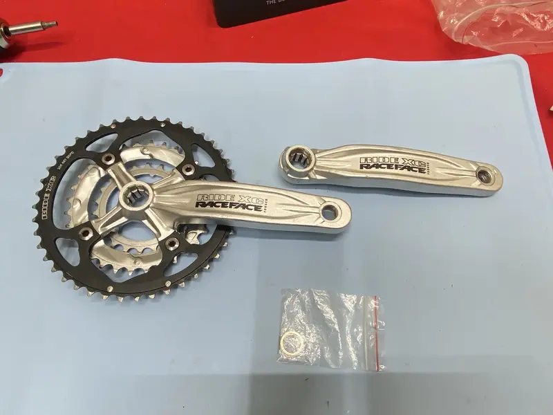

Hi guy, I got GT i-drive 5 and a set of nice looking RF Ride XC cranks. Could someone point me to the right direction of spindle length?
I am running them 1x, upload the photo just for reference.

ISIS is 113 or if needed 118.
ISIS standardised it's lengths.
Only going longer for DH type stuff.

Thank you! I also think its 113 but still wanted to ask about it.
Besides that they should also have 121 if I remember correctly.
My cheapo race face isis states 118 in the docs - but I get a better chainline with 113 on 2.1 tyres. So it might depend on what tyre width you're after - although with no inner ring, then your only worry with the 113 would possibly be Chainstay clearance🤔
