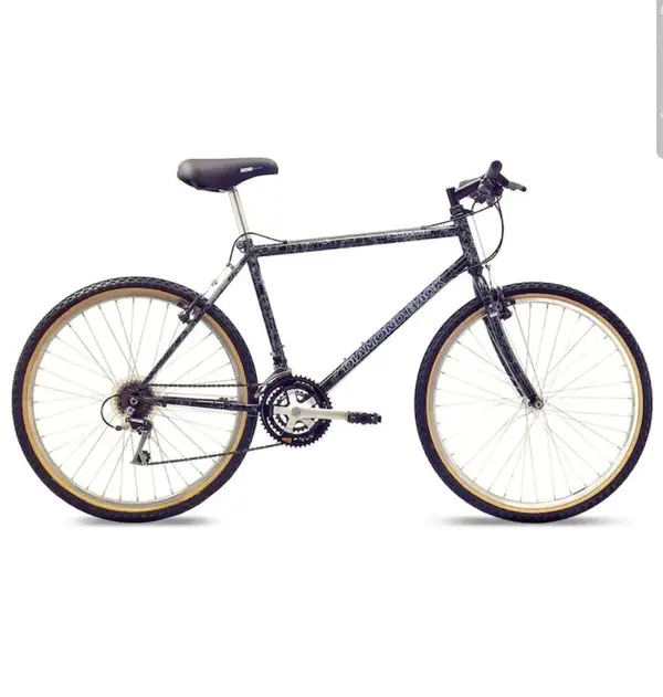

It is confirmed to be a 1992 sorrento, thanks for the help id'ing it. Below is a catalogue image from the 92 range.
