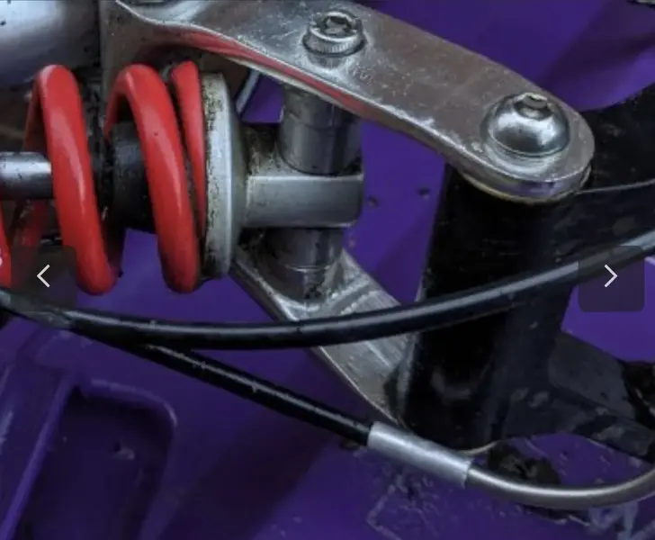

The rear suspension on my 1999 Specialized FSR Comp is a RockShox as above. The bike has been lightly used, and I've never thought about servicing, which shows how much I know about suspension. Now, I'm getting a "clacking" noise from the rear when I hit a bump the size of a sleeping policeman, and there's a seal that seems to have come unscrewed. You can just see it in the centre of this picture.

Err, well if you take it to a shop, it's going to be expensive. Possibly (probably) more than the shock itself is worth.

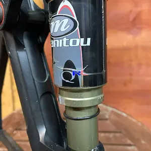

Closer pics required. You're not talking about the conical end rubber stop are you? That's meant to be there.

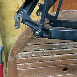

Is the “clacking” definitely coming from the shock? A bike that age and it may well be pivots.
Valve bouncer is right, no shop will be able to help with that shock. Service kits ran out years ago. If the one you have is gone, all you can do is take a risk on a second had one or stump(y) up for a new shock. May even be cheaper buying a donor bike for working parts.

You can probably find the pivot bearing sizes and buy them from a bearing supplier then you will save money. I did a similar thing on this azonic frame and the bearing / bushing costs came to about £35
My guess at the clacking would be that this bushing (between shock eyelet and frame) has gone / worn, but get the rear triangle and give it a wobble.
My brother had this exact bike and even his ham fists managed to replace the pivots.

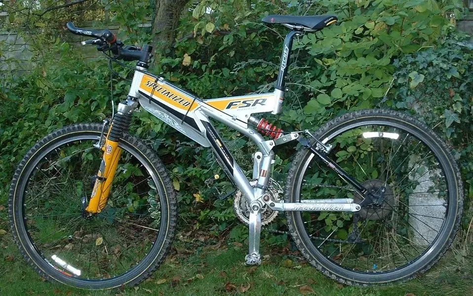

Though I'd chuck both sets of suspension in the bin that is an absolutely classic FSR Comp in original condition so I could understand if you wanted to keep it like it is. If, however, you did want to take that Coupe Deluxe and shove it up Mr Rockshox's fundamental orifice for making such a piece of shite in the first place then there's good news. At the very least RS and Fox still make new suspension in that size (165x38 ) and there always seems to be decent availability in that size in the used market as well. Maybe take that Judy XC to Mr Rockshox as well and see if it'll fit, then get yourself a period correct Bomber.
