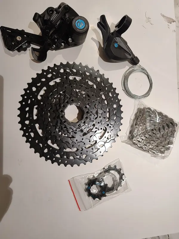

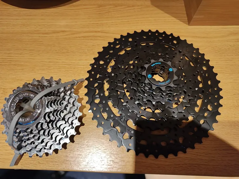

Hi - looking for any insight into Dos and Dont's with Box 1x9 mini gruppo... I have done 1x conversions on restomod bikes before using Shimano and Microshift - but the Box kit is new to me - I figured it is worth experimenting with at just £99 in the UK - that's a lot of kit for the £££ - and even cheaper than Microshift - but what are the pitfalls? - I would love to know things like do I have to use the supplied chain? - How about the shift cable? first impressions on unboxing = OMG that freewheel is mahoosive - dinner plate size box_3_prime 9 _11_50.jpg

So far, on first impressions, I would say the rear mech is extremely solidly constructed and has potential to perform well and last, likewise the freewheel, both are moderately heavy. The shifter feels more flimsy and very like Microshift units. I am awaiting delivery of cranks and chainring to finish this build but will post when complete and tested. The cost is similar to Microshift Acolyte 1x8 ( will also fit on 7 speed freehub body and act as 7 speed). The Microshift setup is not as bomb proof as Box, but is still good quality and exceptional value for money ( check out prices at Kids Racing). The only issue with Acolyte is the odd non Shimano compatible cable steps and sprocket spacing but I do like the light action . Microshift also do Advent 1x9 but that again does not fit on the shorter 7 speed freehub body that you will find on most vintage Shimano hubs. The Box three 1x9 freewheel is for newer Shimano 9,10,11 freehub body which is on post 2001 hubs so watch for that, the size is perfect replacement size for 9 speed Shimano freewheel. I would also warn that derailleur hanger is not low enough for the enormous 50t freewheel in the Box Three kit , so an extension for the hanger is needed for older bike frames I will post pictures of that when finally assembled. Summary, the Microshift Acolyte 1x8 ( and 7) is more straightforward for retro bikes albeit not mixable with Shimano. If doing restomod on 9 speed rear wheel, then the Box three ( or four) will be more compatible. Both are cracking value for money and have the all important clutch to prevent chain slap. Note that if you want to use retro thumb shifters then you may have compatibility issues. I only use these 1x kits where I am going to use the matching under handlebar shifters and dispense with front shifter and mech. The weight saving is considerable over 2x and 3x and less cables and no front mech gives a far cleaner look IMHO.
