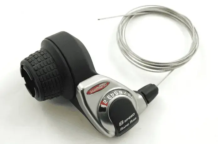

This is the one I use that clearly says Rapid Rise. The numbers are correct, but it does turn backwards to others. The detents and spring loading are in the right direction for low normal derailleurs. There are a few of these left in the UK. Almost non existent elsewhere. 7s is fairly common.
Front derailleurs are all low normal so maybe a front friction shifter would work for 9 speed. But 8 is enough for the Ebike, and the XC bike is now 1x11.
