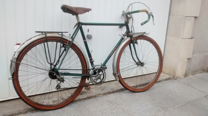

Mmmh. That is old. 50s too at a guess.
There is a horrible steering lock on that and I would stay well clear of that contraption. From one of my tip finds:

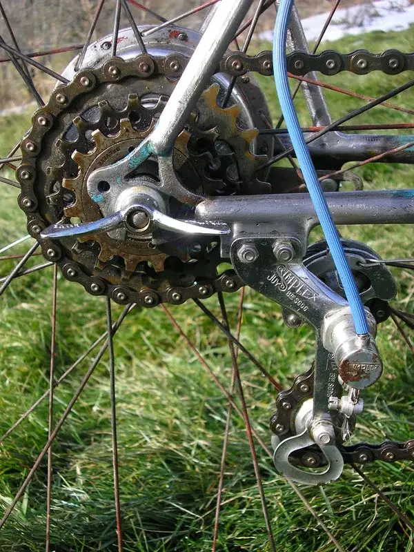

Here's a supposedly '59 randonneuse with 88k serial.

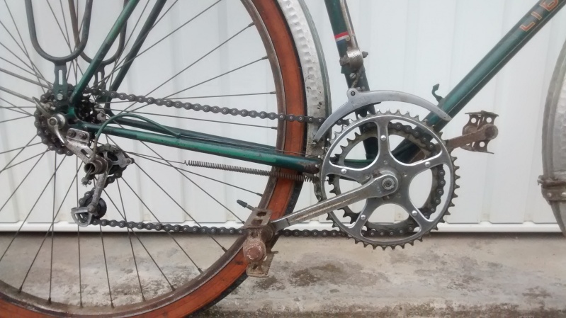

Here's a close up of the original derailleur. Note the spring going from a wee eyelet near the bottom bracket to the mech cage. I was wondering what that mount was for.
And yes, there's a front mech!

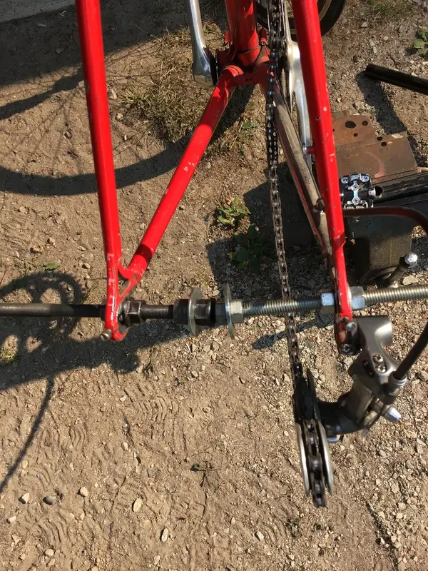

I've re-created the cold-setting process as promised.
I'm not expert - I've only done this 3 times and so far did not have the gates of hell open & swallow up me & my workshop.
I haven't clamped the bridges for the photo, but when doing the actual cold set, it is recommended that you clamp them so they don't break off.
Depending on stay shape, you can drill a wooden block to the right diameter, then cut it down the middle to make clamping blocks. Alternatively, wrap baking paper on the tubes and put some 5min epoxy on them + wooden blocks on top to shape the clamping blocks to your stays. Wait for it to set, remove the paper & you're ready to clamp.
If you're lucky, you might be able to get away with just a pair of cam clamps though.

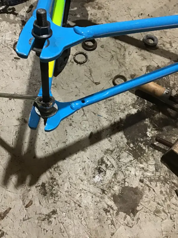

Option 1: M8 threaded rod. I'm missing a nut on the inside of the DS dropout (couldn't be bothered threading it onto a 12in rod just for the photo:LOL:).
Spread to 130+15 by turning the [missing] nut, then unwind & check if the frame has budged. Increase the spread in 5mm increments & keep checking until you reach the target (might have to go as wide as 160 or more).
Almost stress-free, but you're likely to end up with DS stay moving out more than NDS due to the chainring crimping.
This is exactly what has happened with Frannie - most of the spread went to DS and had to be corrected.

Each frame is different, so you'll need to get a feel for the frame but once you're on it, I found it surprisingly easy to get the right amount of bend.
Very stressful when doing for the first time.

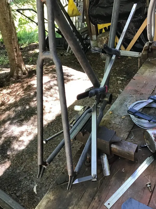

Once spread, you need to re-align the dropouts. I've got a cyclus aligning tool, which was purchased for about £34 on sale, delivered from Germany. Well worth the pennies.

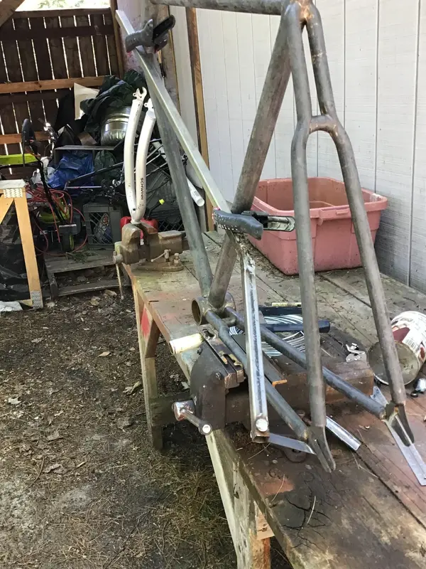

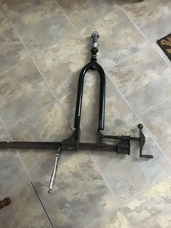

Homemade, free from junk. I had this spread and realignment checked by a bike shop with a real tool and my homemade job was perfect. IMG_0318.jpeg

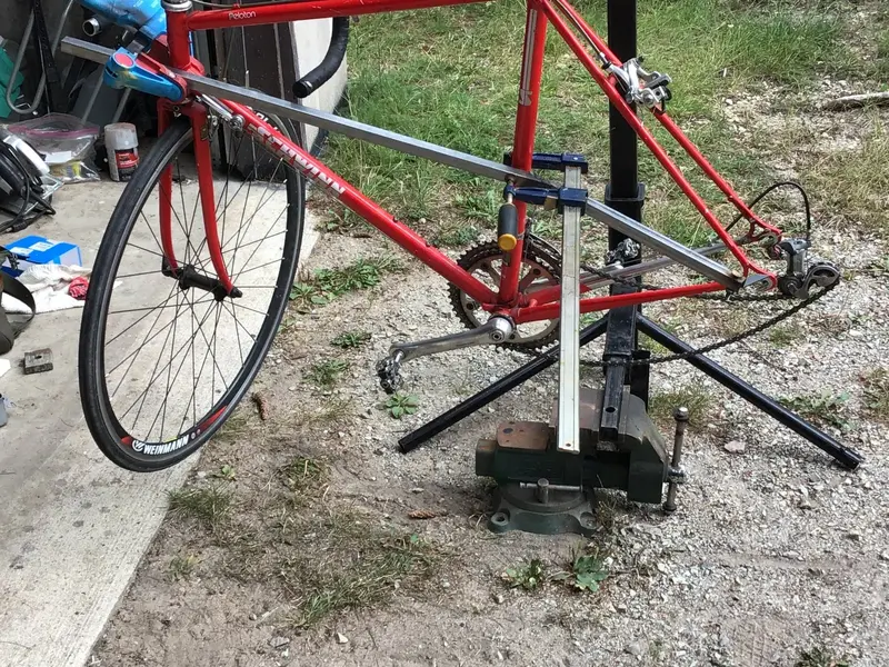

After spreading I use this homemade tool to check the frame alignment. IMG_1726.jpeg IMG_1725.jpeg
