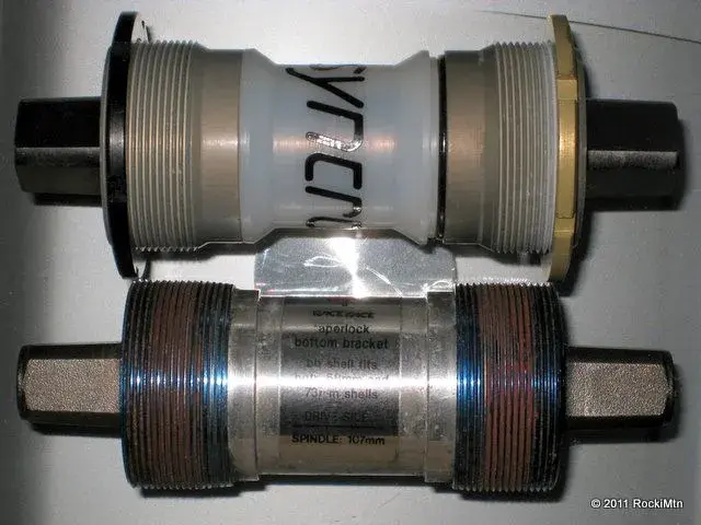

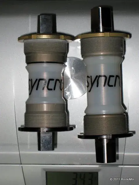

Got two NOS recently. One's 122mm axle and the other is 107mm. But that's not the only difference. The cups are completely different on them and seems the shell lengths too.
My only guess is that I've read there are single and double row bearings. Can both be used for 68mm and 72mm applications???

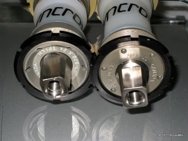

Thread pitch on the cups looks different too?? Italian/English threads??
The difference in cup lengths looks greater than 5mm too :? :?
Nope, both are marked 1.370x24 and should be english threading. At least that's what I confirmed before buying. :?

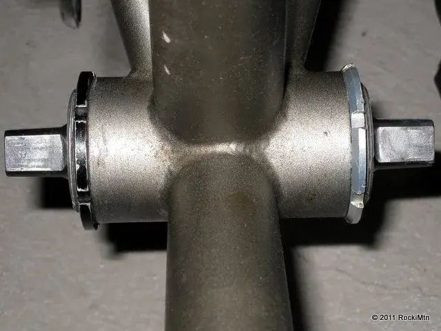

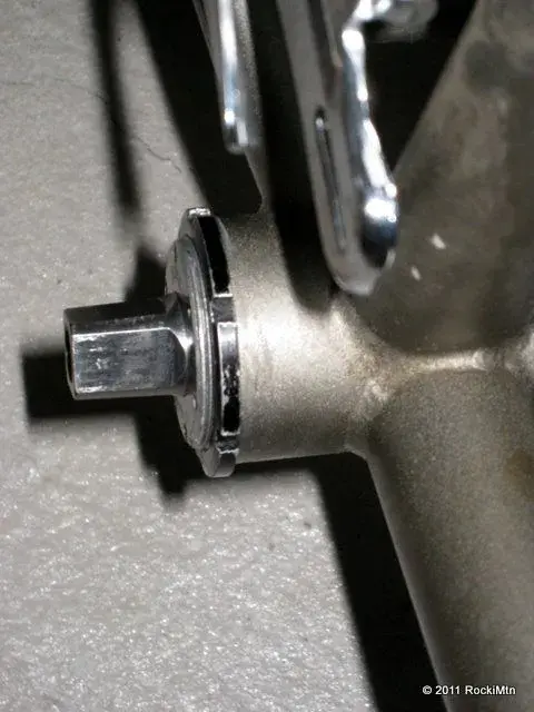

The 122mm, I have a similar used one which is installed.
played with the lockrings and they are interchangeable between the two BB, confirming that it's the same pitch and thread direction.
comparing these to a Race Face taperlock BB that fits 68/72 shells, the Syncros are substantially longer. the shorter one is just long enough to accommodate the lockrings. The longer one has significantly excess threading, which i've also confirmed having installed a used one into a bike with a 68mm BB shell.
curiously though, the larger bb is a few grams lighter than the smaller one. :shock:

Looks like the 122mm bottom bracket is for 73mm bottom brackets only. It probably has a bigger space (5mm?) between the bearings.
