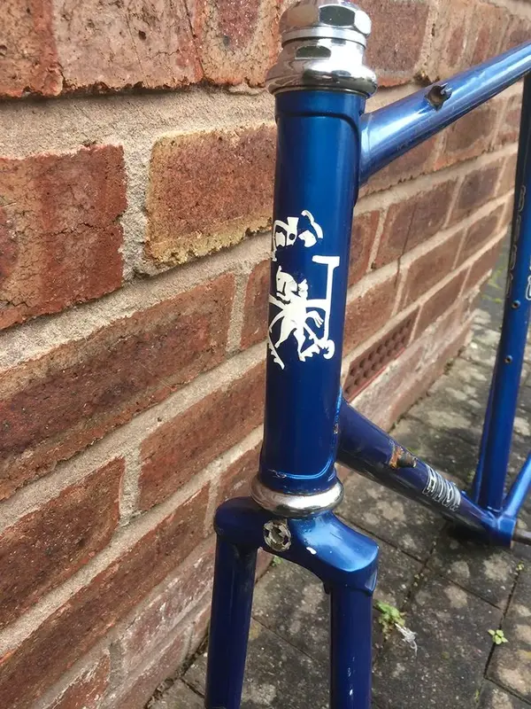

Which makes sense as I picked this up in Stockport. It has a fair amount of scrapes and also rust in places, but isn't looking too bad so I'll keep it as it is apart from some touch-ups, for now at least. At some point it'll probably need a respray but that can wait.
Clearly I was fated to get this, as not only had it been knocking around on FB for ages with no interest (I actually nearly bought it instead of the Holdsworth), oddly someone has at some point added a very crap attempt at a Holdsworth head badge:
Obviously that's coming off, first thing. Luckily they kept the other decals on, as the only frame number I can find is a very faint '16 1', so there's no way I could have identified this otherwise. The second job is that there is a stubborn bottom bracket cup to remove, where I'll try the thread and washers technique to hold the removal tool on whilst using a large spanner.
