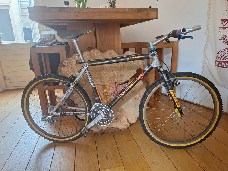

Koga miyata skyrunner cbl from 1990. This is the same frame as the gold plated 100th year anniversary model. It is also very similar to greg herbolds bike from a 1990 article ( https://www.retrobike.co.uk/gallery2/v/Manufacturer+Archive/Miyata/Articles/Elev10k/hb1C.jpg.html ) and I thought it would be cool to inspire my build on this bike. An exact copy is out of my league: frame, tioga disk drive, onza porcs..... so I am taking artistic liberties with my build ;)
Lately I have been hoarding parts and as everything is slowly coming together I thought it would be nice to start a build thread and document everything.
Shoutout to friends, family and the dutch mtb museum for helping me out so far!

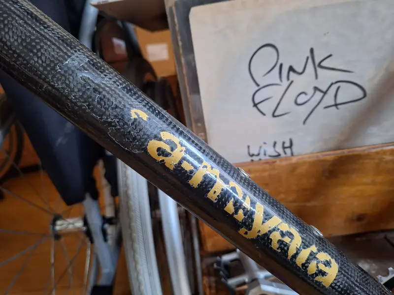

This is how I got the bike, mostly originaliteit but pretty rough condition.

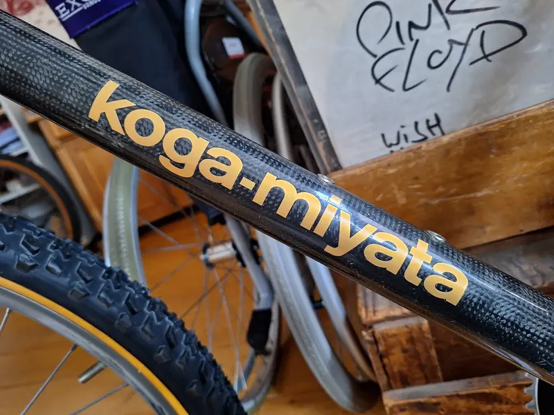

The clear coat on the carbon tubes was in good condition but the decals needed replacing.

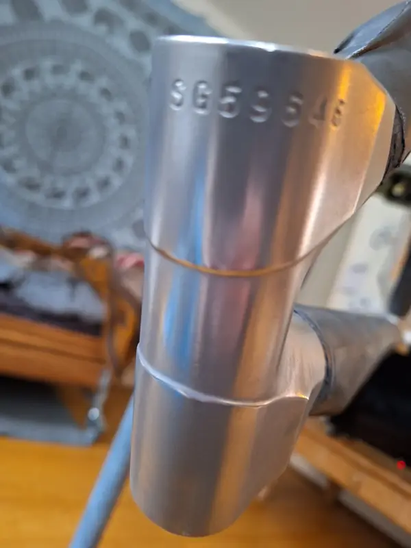

The rear end and headtube needed to be restored. Last weekend I pearlblasted the frame. The rear end has the perfect colour and only needs a clearcoat. The headtube and seattube lugs need a good polish and a clearcoat. I hope to finish the frame later this week.
The detail pictures are after pearlblasting and some polishing.

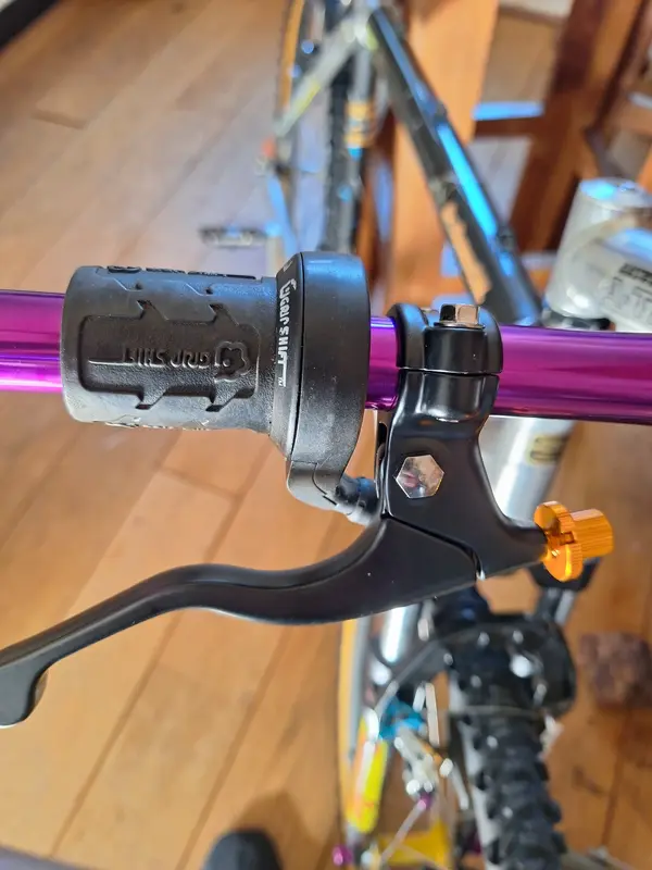

I found exact copys of the motorcycle levers greg uses on his bike.

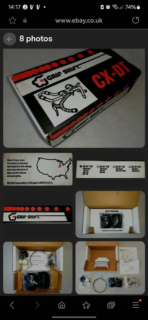

Original grip shifts are in their way from poland.

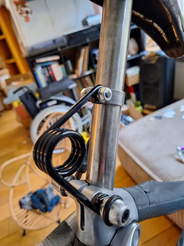

The hite rite was all rusted, now painted Black and I have polished the xt seatpost so both match the reference bike.

This picture shows kind of wereld Im going.
The saddle will be replaced by a san marco rolls.
A fellow retro geek (thanks wim!)got me a 1" answer atac stem. It is a 150mm with some rise, if you have a zero degree one I am happy to trade. I also have a Black 1 1/8" available ;)

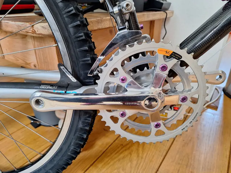

Chainset will be replaced with stock shimano.
Tyres will be replaced by panaracer dart/smoke reissue.
Forks are rond wp and will stay.

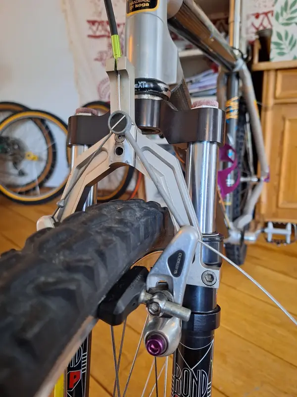

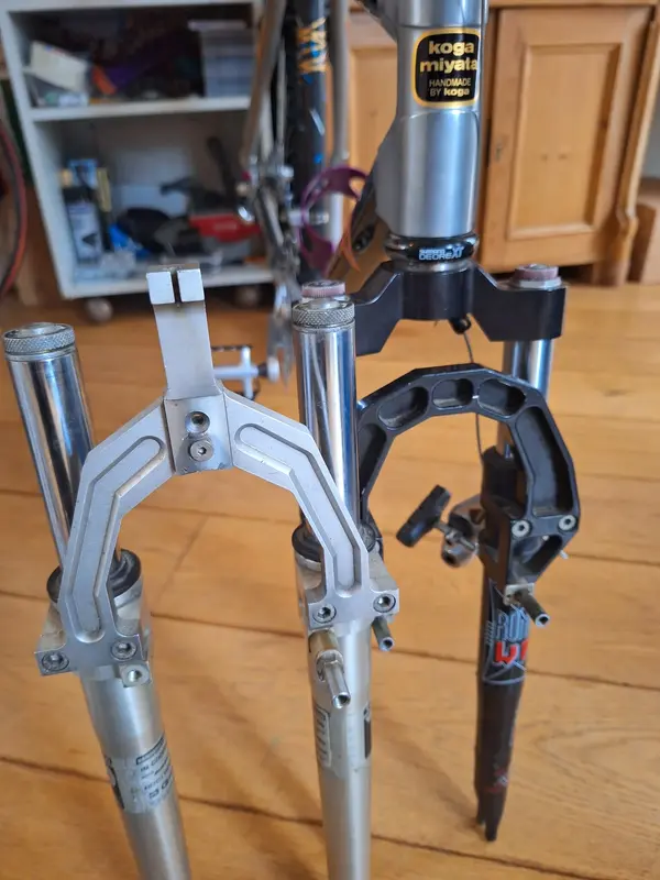

Yesterday I had a good laugh with myself after installing the front brakes: I had used the noodle from the stem to guide the brake cable but, of course, this does not work with a suspension fork.
I looked online for a cable hanger but couldnt find a good looking solution, only from tektro which looked pretry decent.
This morning I checked the shed for a spare parts rond fork and got lucky. Altough they are different models the spacing between the bolts is the same.
