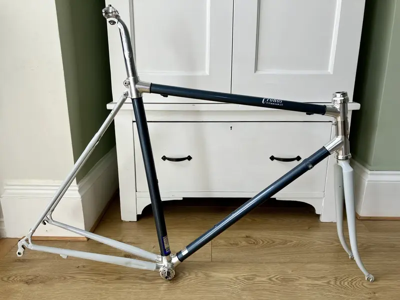

My other Cronos did have a comprehensive build thread, but it was from a time when we used Photobucket accounts, and I found that my pictures were all deleted at some point. I do have some photos here and there on various devices that I’ll try and upload, and failing that I’ll piece the story together with new photos to show the details.
I can’t believe how rough it was when I first took it on.

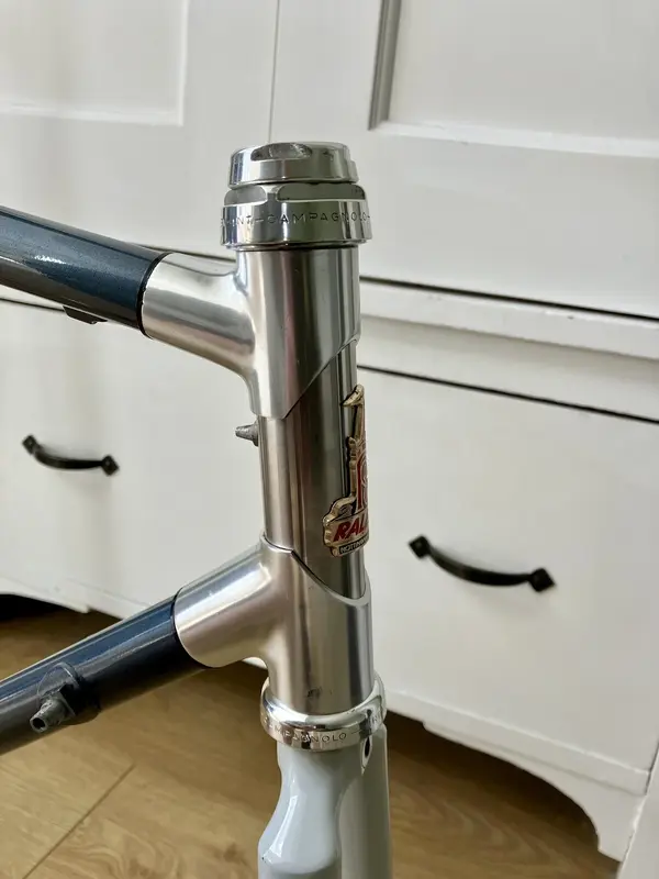

I could have kept the Stronglight headset as it was a perfect fit, and actually the later variant which uses the replaceable cartridge bearings. It’s light, and would polish up well enough, but the C Record headset is such a distinctive design, that I think it would be too noticeable that it was missing from the group. Typically for Campagnolo’s headsets of this era it’s a tall stack height which doesn’t quite suit the length of the fork. I measured everything twice, and decided to just give it a go. That C Record headset locking is literally on by two threads - but it’s on, and that’s what matters!

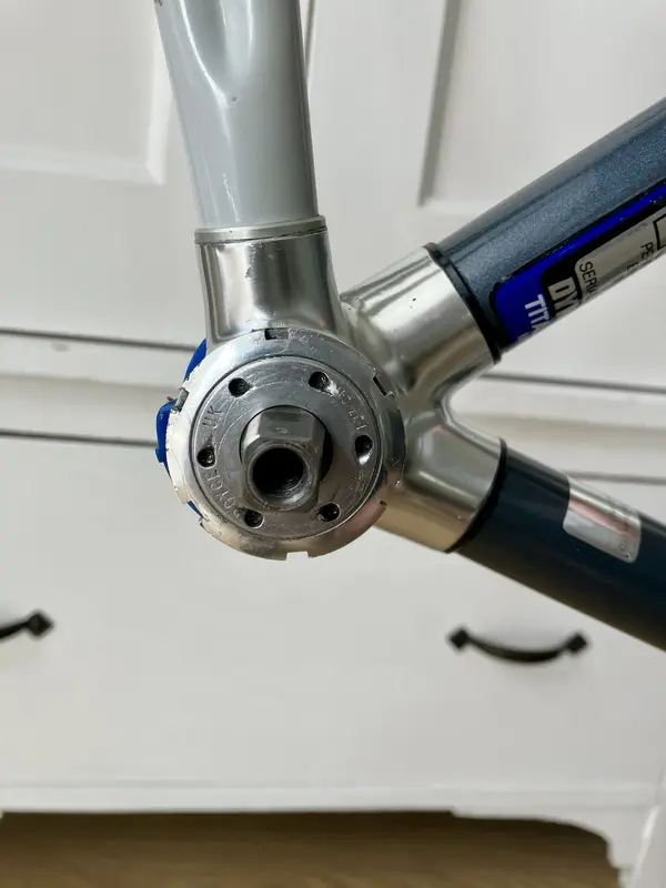

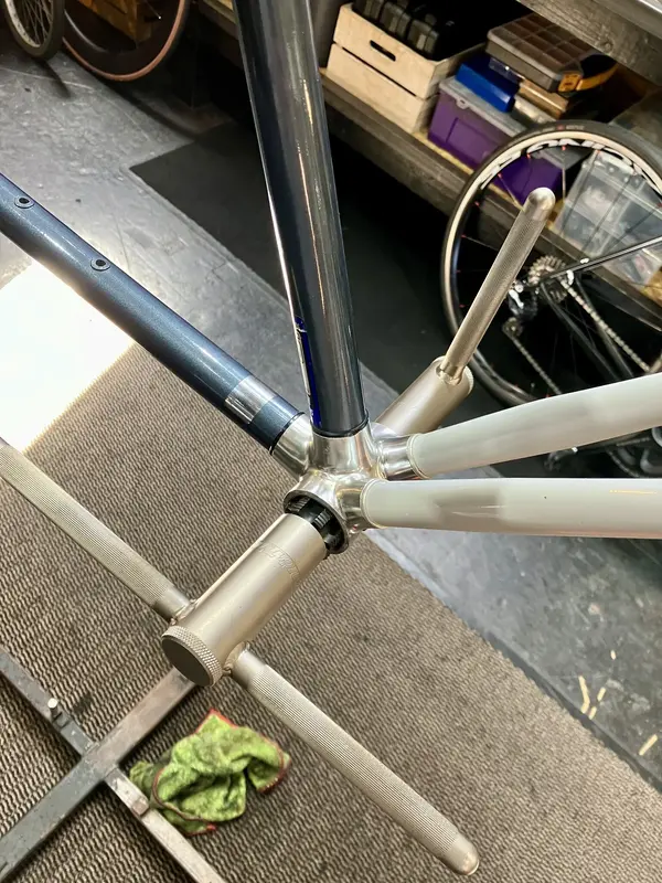

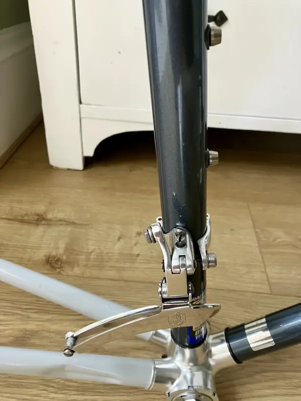

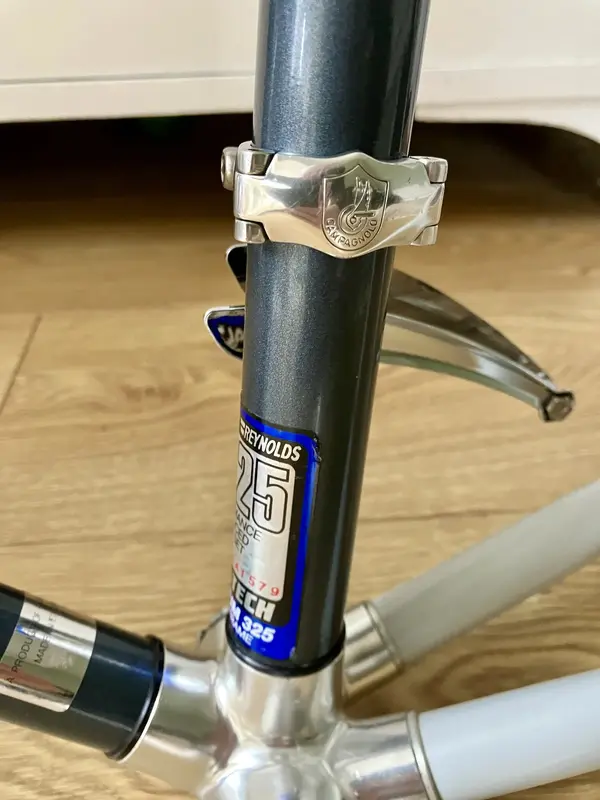

The bottom bracket was never going to be a C Record one, and there’s a few reasons why. Firstly, they’re really difficult to obtain in a condition where they’ll run smooth. Secondly, if you can find one smooth enough, then you’ll almost certainly pay for the privilege. Thirdly, they wear out! Simply by their design of using ball bearings against the axle, they will eventually wear out.
The answer was always a Royce Titanium one, and I think it’s really fitting for this bike. The hardship is finding one in decent condition that’s the correct size. Half of the people selling Titanium BB’s don’t know whether they’re ISO or JIS taper, and some don’t even list the axle width. 111mm is the standard Campagnolo axle width, and I found a very rough 110mm ISO set up. Everything other than the axle was knackered, which is actually the most important bit. You can use various manufacturers cups on Ti axles as they almost always use the same cartridge bearing. Luckily though I had spare set of Royce cups to use on this one.
I tried to thread the cups in as a test fit, but I could barely get them started, so a trip to my cousin’s bike shop to re-tap the threads (in exchange for beer) was on the cards. The taps were struggling for a quite a while, especially in the non drive side, so 10 mins of back and forth until I thought I’d give the cups a try. The difference is night and day as the cups go in by fingers alone. I never force BB cups as it can be catastrophic, especially when using two pin Campagnolo tools to install, as one slip of that spanner…!!!
The reason why the taps might have found it difficult to cut a thread is because the alloy shell uses a steel insert for the BB. I cleaned it all out with a wire brush and once it was clean enough, I coated it with a liberal amount of grease.
Brand new Enduro bearings went in, and the whole lot was tightened in place. The beauty of this set up is that it’s infinitely serviceable with new bearings every few years.

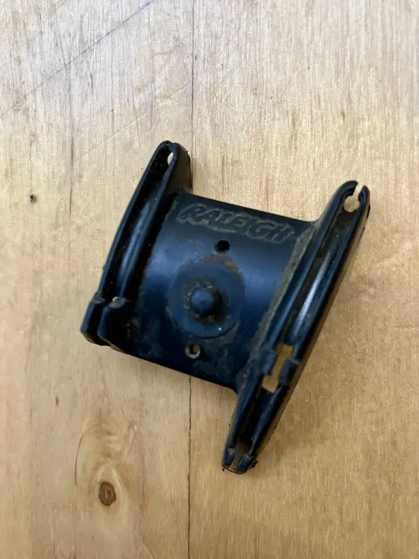

Not much of an update, but worthy of sharing some recent good fortune.

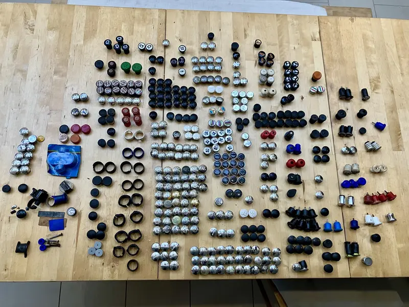

I bought a box of assorted bar ends from eBay this week, which were actually quite local to me. I contacted the seller for more detail on the assortment, but no reply. Anyway, the listing ended and I was quite happily the winner. The bar ends didn’t really interest me as I was really keen on something that I’d spotted in amongst the bar ends, and that was the little plastic bar clamps which hold the end of the tape neatly in place. I used some on my Look KG96 earlier this year, and was keen to hunt out some black ones.
Once the box arrived, I set about playing a game of matching up pairs with my youngest son (he’s only 8 years old), who was surprisingly engaged in the task.
At this point, I was really interested in the various types and colours of bar tape clamps I’d just bought. Interestingly, there are a couple of versions, of which one type has two slots to allow for an ergopower set up.

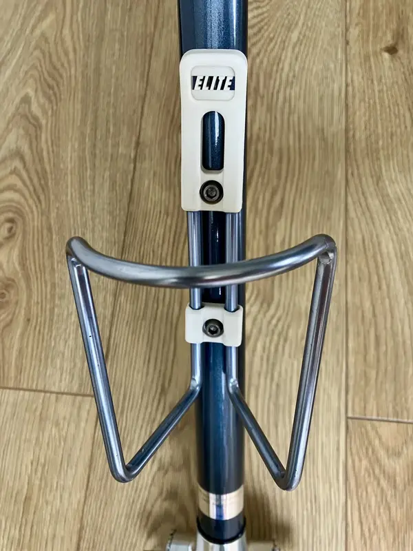

Then my son picked this up out of the bottom of the box…
I couldn’t believe my luck! My frame has lost its original Raleigh cable guide at some point, and finding another at a reasonable cost seemed unlikely.
A small part of its story, but a good story nonetheless!
