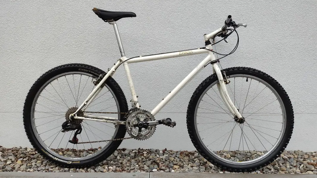

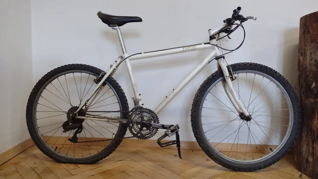

I recently stumbled across this bike on the net and couldn't resist.
The condition is visually pitiful.
Technically less bad but also far from good. The left crank and pedal are completely missing, the rest is so dirty that nothing works anymore. The paint and decals are beyond repair but the frame is fine, no cracks, dents or excessive rust.
I have now mounted a new tyre on the rear, left crankarm and roughly cleaned it.
Next it will be disassembled and prepared for the new paint. The search for parts is currently underway, the new decals are already finished. As soon as the Rockhopper is finished I will continue here.
I think it will be a nice bike when I'm done with it.
I couldn't find much about it until now. The bikes are hard to find in Germany. It could also be from 1990, but I'm not sure. If anyone knows anything, I'd be grateful.

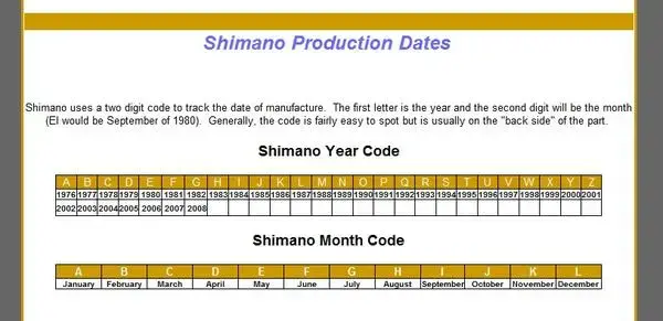

Possibly 91/92 just going by the brakes, as a lot of manufacturers skipped DX in '93 for the modern looking LX
I think it has been tinkered with a bit as it also has a Sachs Centera rear derailleur. That was more on the market in 1995/1996.
