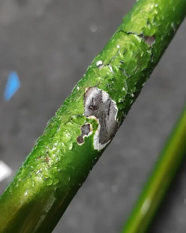

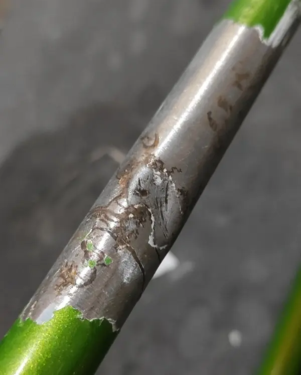

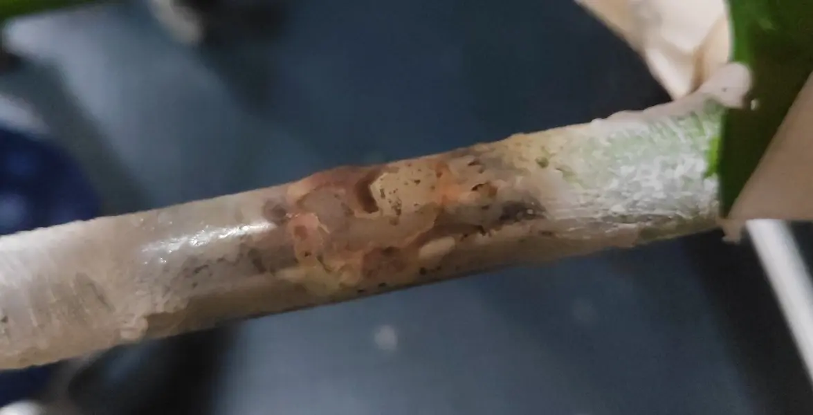

Sanded back the surface rust to get a better look.
It's quite a dink. Question is how bad is it? There's no hole or crack, could this be filled? Or am I looking at replacing the stay?
I believe this tube is Reynolds 753.
Always disappointing finding things like that. The picture probably makes it looks worse. Personally I'd just clear coat it or colour match and build it up and if it still bothered me after a while then I might look into a repair from one of the original builders at Roberts. I'd definitely leave it rather than fill it though.
After reaching out to a couple of people I'm happy to report that all agreed the dink is not a big deal, and it certainly doesn't warrant the tube being replaced.
So I'm going to send it to @danson67 who will roll the high spots out, before filling what remains of the dent with silver solder. Having seen some of his handiwork I'm very grateful that he's able and wiling to do it.
After that it's going for a repaint, they will match the colours and recreate the decals.

FWIW I would agree that the stay should be okay, assuning that the stay itself hasnt been bent in any way? Brass filling and retouching probably is the best way to go.

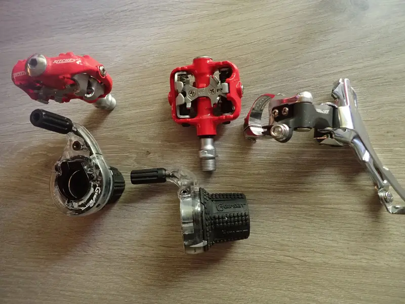

Some missing pieces of the puzzle have turned up. Red Ritchey pedals, a NOS 737 FD and some clean uncracked XRAY Gripshifts.
The pedals were a lucky find, they were for sale on an obscure US marketplace with low trust ratings for $22, it was a gamble and a mission to get them here but worth it, they look to be unused. Massive thanks to Ray Cruz for helping with the purchase and shipping.

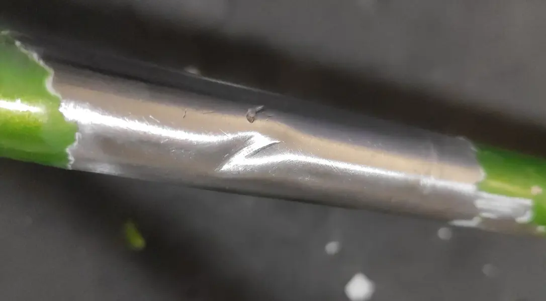

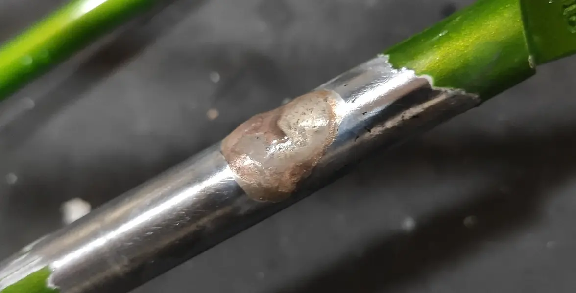

@danson67 has done a beautiful job on the repair, he kindly took pics at each stage of the process...
Paint stripped

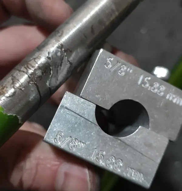

High points rolled out
Cleaned for soldering
Silver solder applied

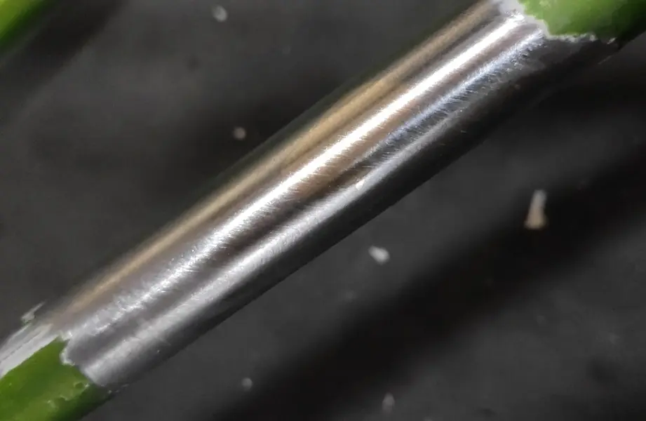

Filed back and ready for painting
It's very reassuring to see the quality of Dan's work, any lingering doubts about structural integrity have been well and truly laid to rest, total peace of mind.
