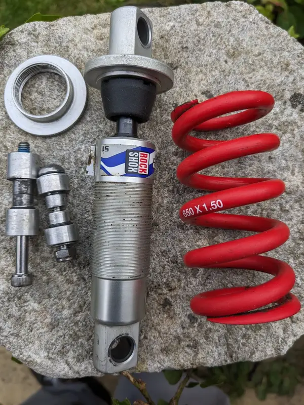

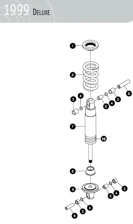

OK so I've replaced the transmission and gear cables on my Brompton, and sorted the rust under its BB, so I've got back onto this one now. Removing the suspension was easy of course, but I think I now see what valve bouncer meant. The Deluxe looks like this variant, which is literally unserviceable because the core of it was supplied as one unit.
The displaced seal came from the bottom of the body, which is that core unit (part 7 in the attached), and simply pushed back into place. However, when I move the shock by hand, I can feel some roughness part-way along its travel, which is presumably not normal. I don't think the bushes are unduly worn - and, as I mentioned before, the bike has not been used heavily.
So maybe I'm looking for a new unit to fit.

So it appears to be either 6 x 1.5 or 6.5 x 1.5.
I.e. 165mm x 38mm
Something like this may fit? (with the right size bushings)
I've measured it up at 6.25*0.75". Does that make it a toy, with so little compression stroke? Is anything that size even available?

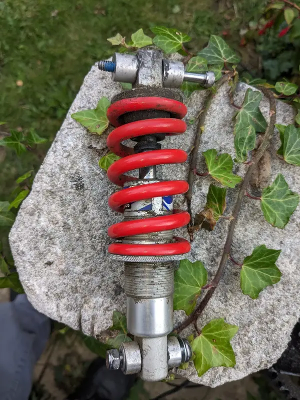

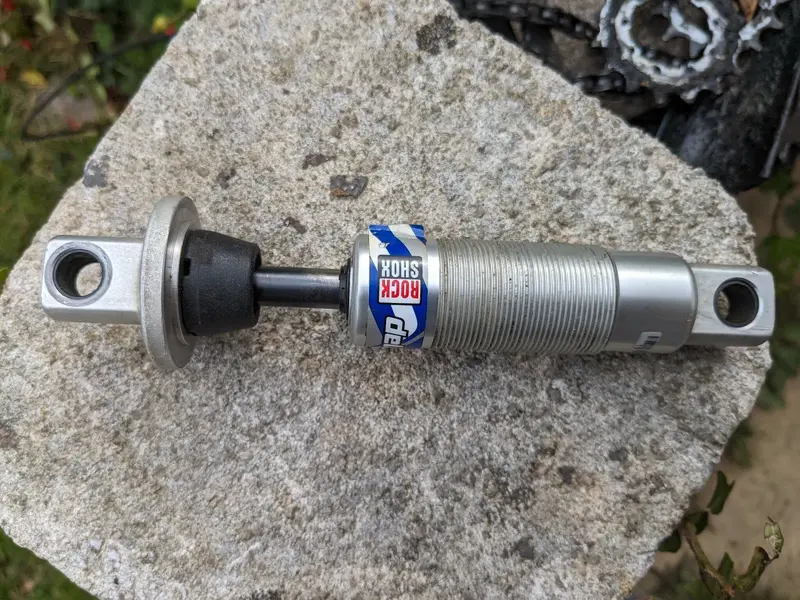

Thanks, because that made me think again about what I was seeing and whether it made sense. My measurements were correct, in that there is indeed 0.75" of smooth travel in between the two hard stops in my photos below. However, the bumper stopper wouldn't then get compressed before the limit of travel, and you'd definitely get the effect in my original post:
... a "clacking" noise from the rear when I hit a bump the size of a sleeping policeman...
So I reckon something fairly catastrophic has happened in there. I did say I wasn't exactly pushing this bike to its limits!
I've looked for @rc300's circlip and not found it. In fact, I can't for the life of me see how to get the thing apart. I don't know if it was some kind of one-time press-fit assembly. And it may not be worth the effort, as I probably won't be able to fix the issue anyway. So at present I'm focused on the best replacement to get something suitable to the kind of light use I'll probably give it, but serviceable because "bike" and "can't take apart" together make an oxymoron.

No, I moved the sticker to check. Can't see anything, it's weird, bit like a ship-in-a-bottle assembly on the face of it, which is impossible, so I have to be missing something but, as above, don't think there's much to gain from taking it apart anyway.
Currently looking at a RockShox Monarch RL, but I'll have to save up some pennies even for that. If anyone knows why that particular unit wouldn't fit, please shout!!!
