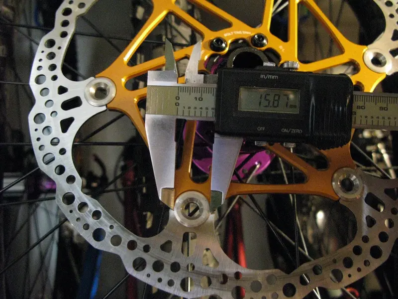

Floating Hope Rotor outside Rivot OD ( as pictured ) there is of course and inside portion of the rivot,
which is the pressed side, no pic you want one ?
Some folk get terminology mixed up, so in case its the mount bolt heads ? ( see pics )

Yes for floating rotors...
But no that's what I meant. That's the outside flange diameter.🙂

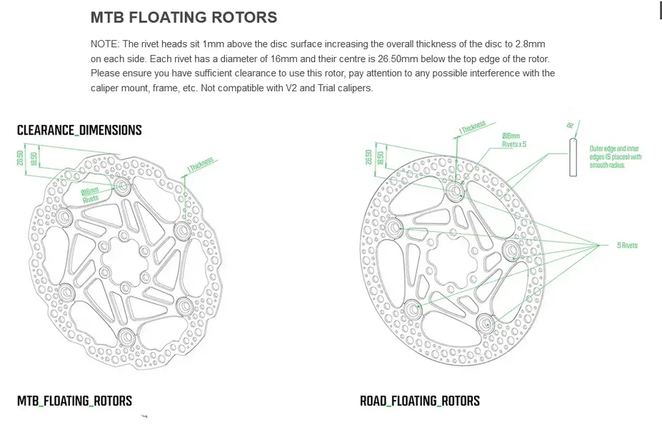

Hope 180mm Floating Disc Rotor, MTB.

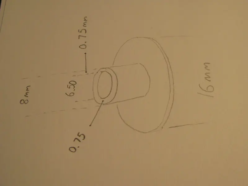

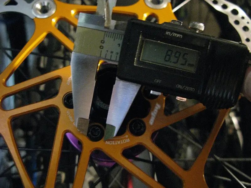

Used a strand of copper wire to fit into the expansion gap, approx 4mm in both
sides from the flange outer, knowing the ID@6.50mm and OD@16mm my best
