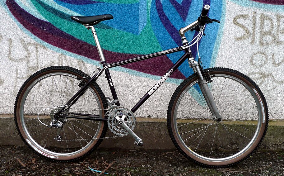

1993 KHS Montana Pro
24.32lbs on my digital scales
1993 KHS Montana Pro by
thecycledoctor.co.uk, on Flickr
The parts listed in red are OE parts.
True Temper OXII tubing
Mag20 fork with Mag21 canti bridge (Period correct)
Stronglight headset (possibly period correct)
OE Zoom Competition stem
OE Zoom 130 bars
Cube sponge lock on grips
OE Kalloy Uno seatpost (date stamped 07.94)
OE Bontrager Ti saddle
X-Lite Ti seatpost bolt
OE XT M095 brake levers with shifter pods
OE XT M736 front mech
OE XT M735 SGS rear mech
OE XT M730 crank arms (polished by the Lord of the Sith)
Ritchey 24/34/46t chain rings (possibly period correct)
KMC X8 99 chain
Sram PG730 12-32t cassette
(OE HG70 12/28T cassette en route)
BB UN54 bottom bracket (period correct XT BB M730 en route)
Alivio canti brakes with M System pads
(OE M734 XT brakes en route)
Clarks white outer cabling and silver ferrules
DX hubs with Mavic 217 Sup rims with DB spokes (period correct) (
OE M730/M732 XT hubs with Mavic M231CD rims to be serviced and fitted)
OE XT skewers
Charge Splashback 1.8" amberwall tyres
Schwalbe AV14 lightweight inner tubes
Xpedo M-Force XP-XMF4AC SPD pedals
