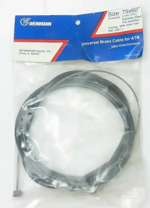

Weinmann 2401-1 stainless 2mm cables have two different sized barrel ends:
9mm wide x 7mm dia.
10mm wide x 8mm dia
I'm happy with the ones I bought from here:
https://www.ebay.co.uk/itm/134222650067
