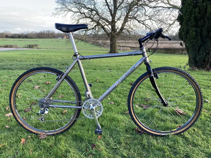

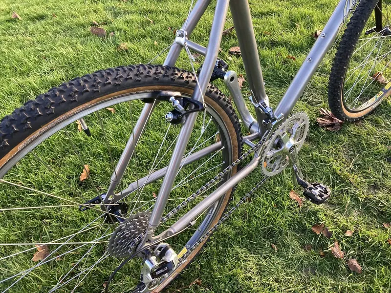

Final spec for the record.....don't forget to check out January BOTM.....all votes appreciated :).
Frame: 1992 Fisher Prometheus
Forks: Fisher Evolution
Stem: Fisher Evolution
Bottom Bracket: Fisher Evolution
Headset: Fisher Super Light 1-1/4"
Brake Cable Hanger: Fisher

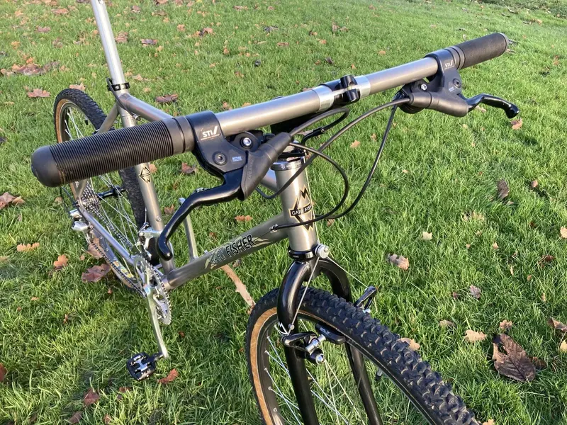

Bars: Titanium WTB, finish matched to frame
Seatpost: Unnamed
Seatpost clamp: Ringle
Hubs: Shimano Deore XT Black
Rims: Mavic M231CD
Tyres: Ritchey Z-Max WCS 1.7
Quick release: Ringle
Pedals: Shimano M737
Shifters / Brake Levers: Shimano Deore XT STI
Front Derailleur: Shimano Deore XT
Rear Derailleur: Shimano Deore XT
Brakes: Shimano Deore XT Black
Crankset: Shimano Deore XT

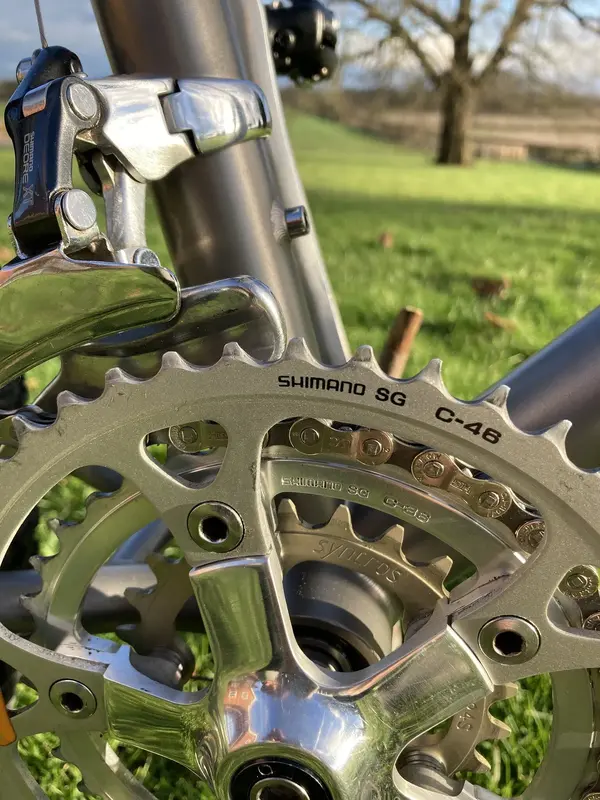

Chainrings: Outer and Middle Shimano, Inner Syncros
Chain: Shimano
Cables: Shimano SLR and SIS

Thanks Swede, my first time on a Ti restoration, same as steel only more filing (much more) :LOL:..... I got lucky with the Paragon inserts which were a perfect fit, saving the hunt for tubes and then machining....obviously couldn't have done it without the expert welding from Gavin.... and the blasting was messy but really satisfying. Bonus is no painting!!! Go on, take the plunge!
