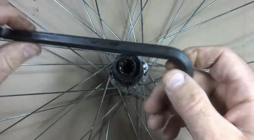

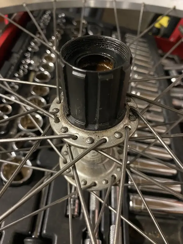

Hi . I am after some help / advice . I have a slipping rear hub on my GT Talera . I’ve watched YouTube and managed to remove the rear cassette but can’t undo the hub. I’ve tried RJ The bike guys way but the Allen key doesn’t locate onto anything. What am I doing wrong 🙁

No luck with this method? Is it a 10mm hex you are using?
🤔 did you use the long bit? 😳
Sometimes the freehub body stops the hex from reaching far enough in to bite. When doing this a vice is very handy indeed. Clamp the short edge and use the handle side on the inside freehub and you should feel it engage (don’t use a ball end hex though)

I did try with the handle end .I will have another go tomorrow . 👍🏻
Got it off . I had to put the tool
In from the other side to undo it . Need to get a new one now . It’s very rusty so I think it’s better to replace it
