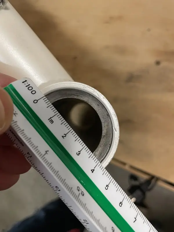

This Kona PhD which I believe is from 2010 needs a headset.
Haven't worked with this standard for ages but it looks like Integrated - aka the bearings that is resting on the frame without cups. The width is about 41.x mm. https://99spokes.com/en-EU/bikes/kona/2010/ph.d states a FSA Orbit #8BE headset but it doesn't help me since it's gone out of production.
What should I buy instead ?
Thanks in advance.
Original here:
I think you’ll just have to try some, if you don’t buy the original. CRC do a 45 degree headset for just over a tenner.

Thanks Splatter Paint! That's really helpful 🙏
