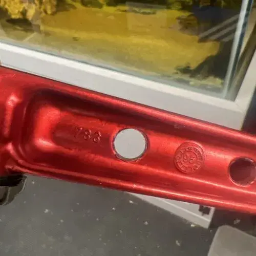

Actually I think the AC cranks are far cooler than the Balance Bike itself ;)
Just realized that the 1996 models FS and AL 750 had those by default.

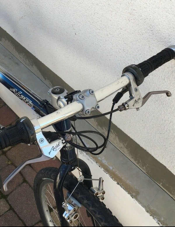

Whoa! Thanks for the scans. The bike in question is in fact a Balance AL 750. From the ad it also looked like the brakes were either Avid Tri-Align or Onza HO, and the scan confirms the Onzas. Very cool!
I've missed to buy once an AL 750 offered in German classifieds.
There was not much too see at the picture, but yes the Onza Brakes in combination with Avid SD2.0 lever

What a weird combo...aren't the SD levers all long-pull and meant for V brakes?
I also share your pain because this bike has since sold in the time I spent looking for answers. And it was listed at only $125 US. I should have bought it first and asked questions later!
Did these ac cranks come in top-end cnc us made model and then, later, a Sugino cast item for OE fitting? (Like white industries)
yeah, typically they have been used in combination with Avid SD V-Brakes.
But Avid has introduced levers already in 1995, a slightly before the breakthrough of V-Brakes.
If you look carefully, and sorry my scan is rubbish, the Avid 2.0 levers are mentioned in the Balance brochure for 1996 too.
The nice Ultimate levers came with different internal chips either for short or long pull brakes.
