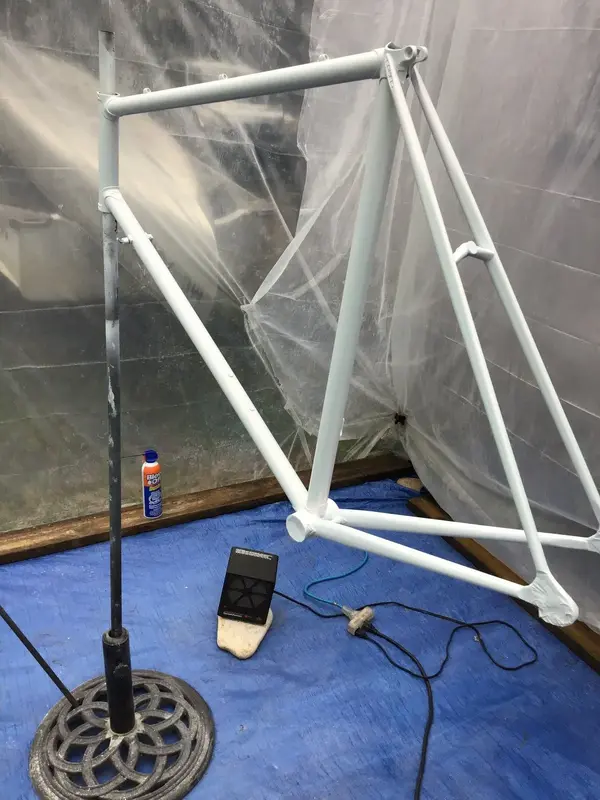

Old rusty Somec frame repaint
good job, told by one who did some attempts as well so knows how hard it is!

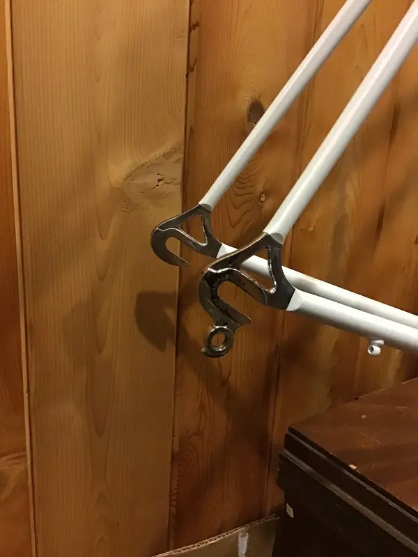

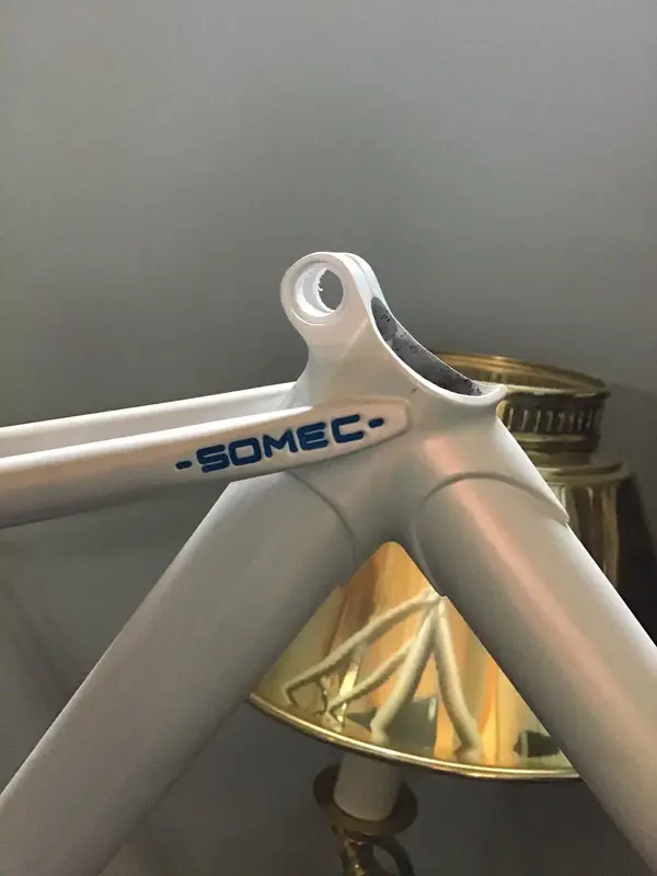

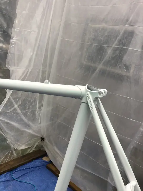

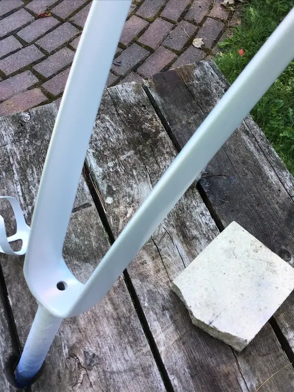

You got that right. Wet sanding between layers, polishing compound on the clear. Oh, no, sanded through The white. Strip it down and start again. Finally the third attempt was good enough. The reduces got old. What you see in the photos is the first attempt, which was sanded down with 1500 wet dry and another attempt shot over it. It’s pretty perfect and I probably couldn’t have gotten it better. The second attempt was great until the decals. We didn’t get the finish absolutely perfectly flat and the decals lifted on some of the edges. Third time a charm. The plan is for campy everything, except for the Look pedals that I already have. Not sure about the seat, probably Brooks B 17.
