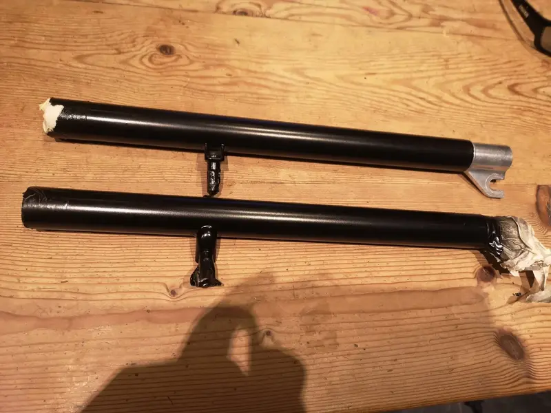

Here's my pair done with satin finish Hammerite, masking tape still mostly in place. If the pitting is severe then a matt/satin finish will help to hide any blemishes rather than a glossy finish which will be more revealing. A pair of stickers later and 99% of people will never know.
Be aware the paint may scratch a bit more easily off the chrome but we are all very careful with our retro bikes aren't we ;).

They looks great. And you’ve masked off the bit that inserts into the crown?

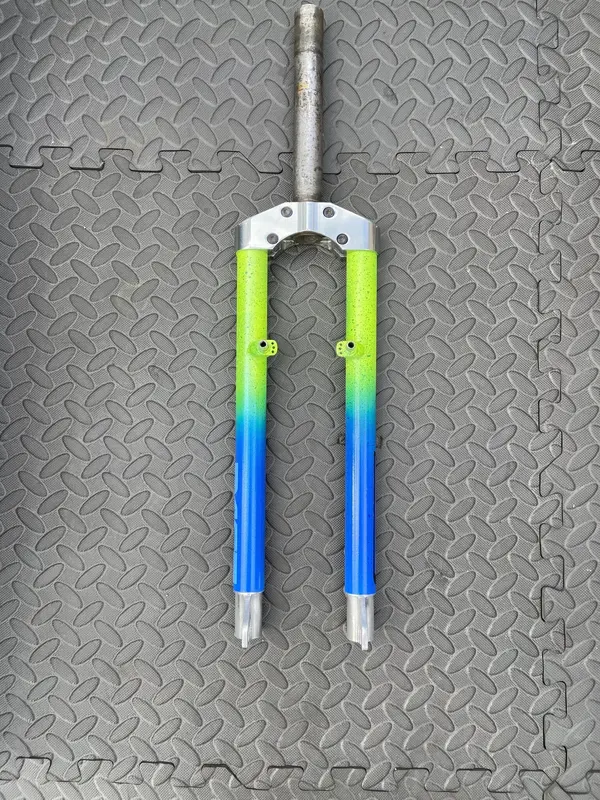

nice coincidence , I was about to post that I spotted a reslly neat looking set of RC30s on one the fbk. mtb pages painted to match a aquafade Yo Eddy… there was another set of gen2 / mk2 RC30s on here ages painted white that I thought looked very cool.
Yes I masked the aluminium dropout, the upper area that plugs into the crown and the brake boss pivot area, the finish depends on how bad the corrosion is and how many coats are applied. you need more and more coats to hide more corrosion. Can you post a picture of your fork legs?
@Bawgixer just done a great job on his RC30's too. 👍
