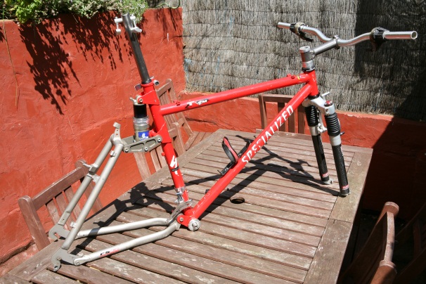

Step 1 – So I already had the frame, with headset fitted, forks, seat post, bottom bracket and a few other bits. Although this might sound like a good place to start, the steerer tube was far too long, so removing the fork, measuring and trimming was done whilst taking a very short break between sanding and oiling kitchen worktops (this is home diy at the weekend, not my day job).
Step 2 – The following weekend… the steerer needed to be nicely finished, forks refitting, stem, bars, grip shifts and brake levers back on. I think I was drilling holes for cabinet door handles this time.

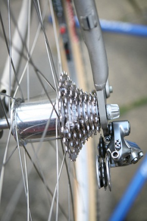

Stripped red anodising off brake spares and fitted the brakes, mechs on, nos chain on (that was a fun job), and finally, brand new fully sealed cables to a standard that I have never adhered to with cables before, and there it was, stood there in front of me just days before the shoot date Mike and I had agreed on. I was into evening work now as I was away on the coming Saturday with the shoot arranged for the Sunday; and to top it all, I had now been asked if I could ride it for the shoot as well!
Oh Shit!!!! The wheels, once shod and mounted with brakes fitted etc., were not as true as I had thought, and the dish on the rear wheel was way out, so up until 3 am on the morning of the shoot, adjusting tensions, dish etc. and then setting up the brakes as well as I could; I was knackered. The only thing left to do was to get all my kit together and get some kip.
