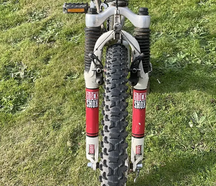

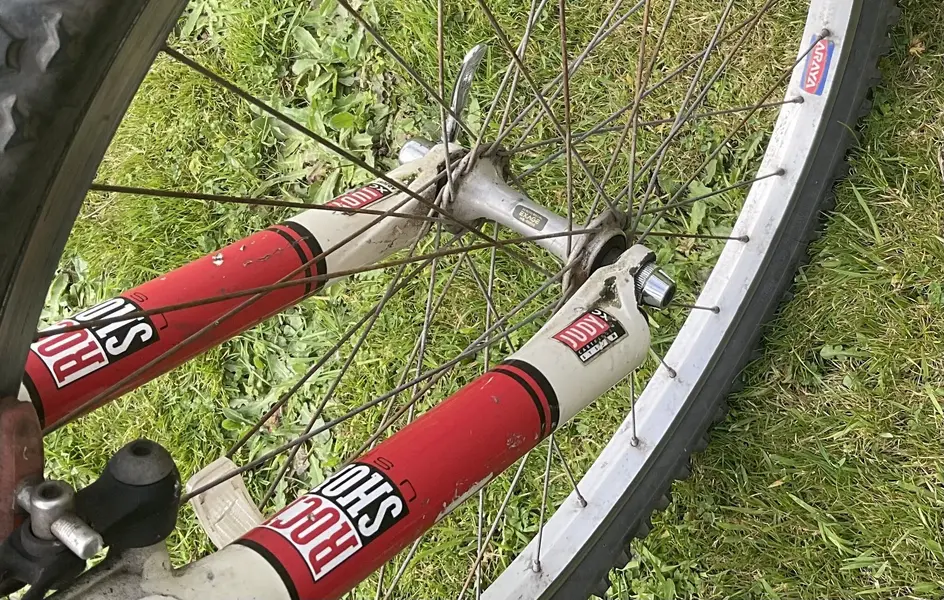

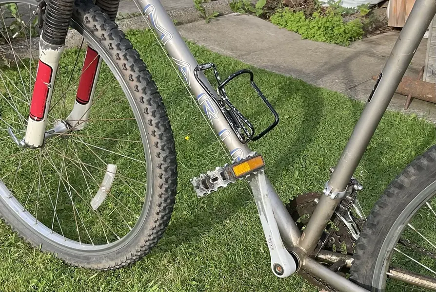

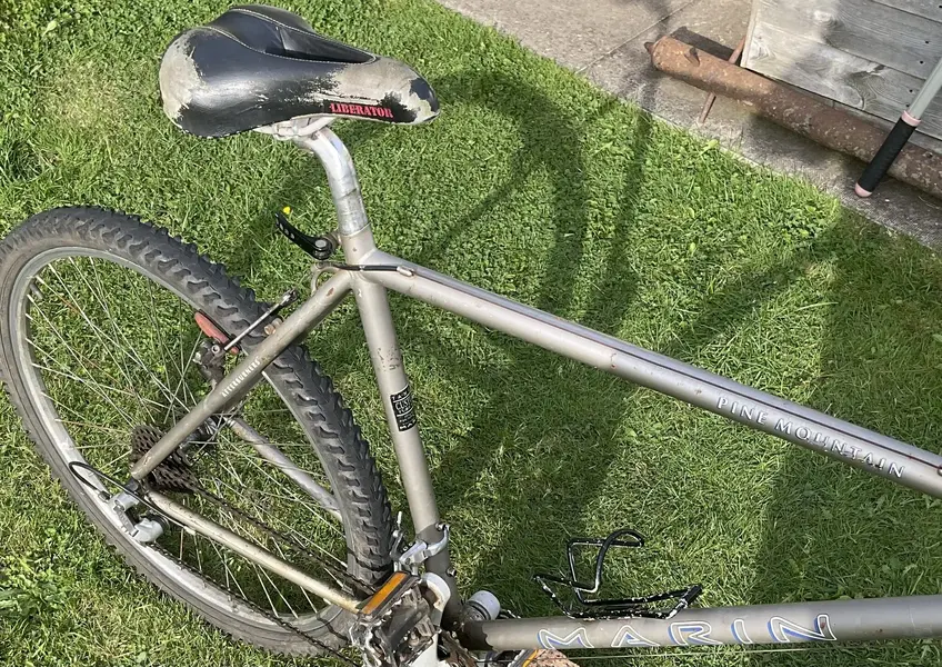

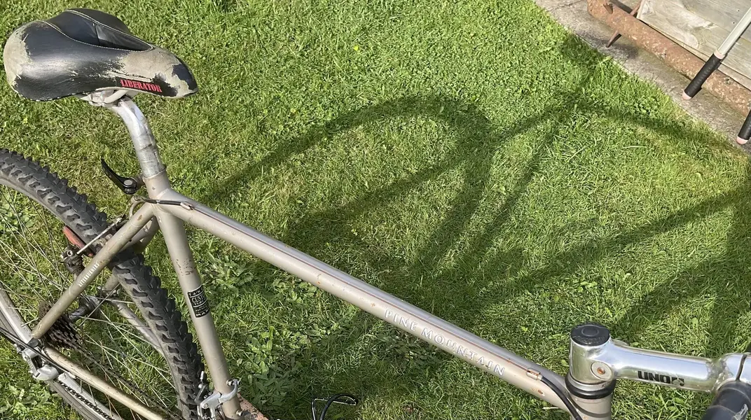

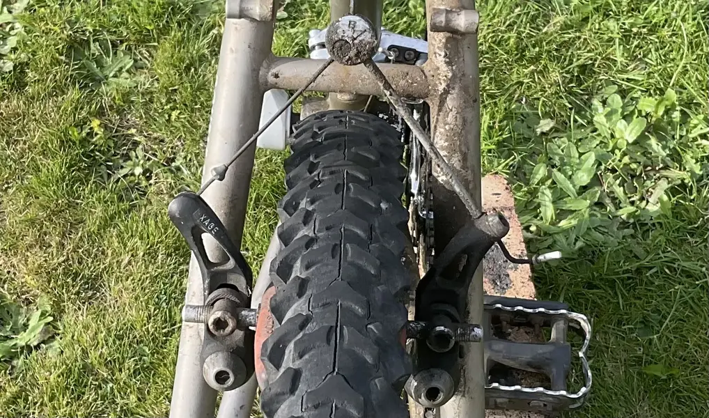

I’ve enclosed pics of the bike as received. Condition is not great, dirty, neglected, some rust. Frame 20.5”. The suspension forks could present a problem: they don’t move up & down.
In theory maybe I can get the bike going again. I like the simplicity and ease of cantilever brakes, and 26” wheels, and 7 or 8 speed clusters. In addition, I like the comfort of front suspension and bar extensions😲, there’s only so much jarring my hands and spine can take these days.

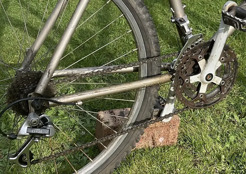

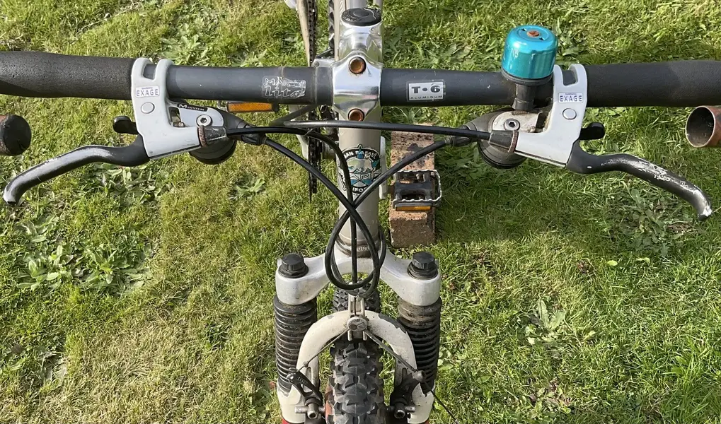

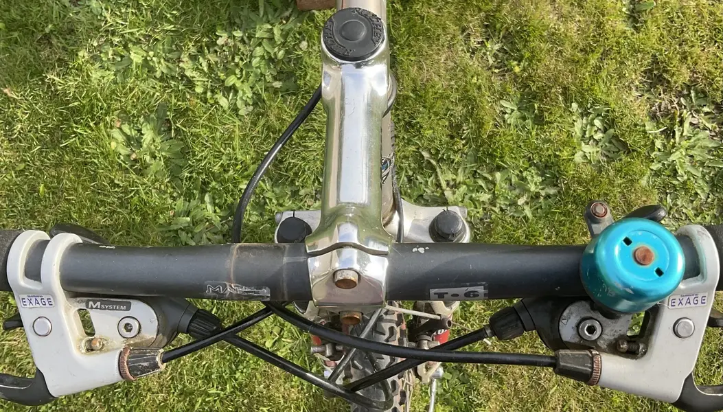

I’d be grateful to receive any thoughts or opinions from anyone on the bike? It came with one Araya VP20 rim & Exage hub, plus a full Exage group set (which I wasn’t expecting?), which all look to have been in place since new 🤔. Rear wheel has been replaced.

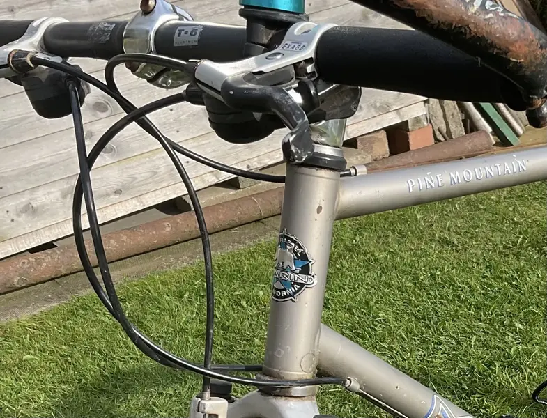

Ritchey Logic headset, Rockshox Judy XC, Shimano Exage M320 175mm cranks, Kalloy seat post.

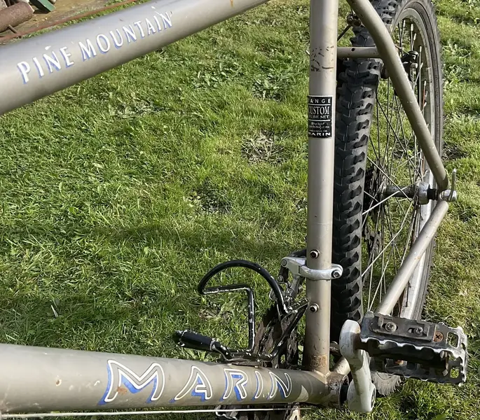

The Marin 1992 catalogue on Retrobike states a completely different set of components for the Pine Mountain, so what may have happened here? - is there any clue to its past from the pics?
The centre of the bottom bracket states 50 12E. Does the 12 indicate January 1992?
The Shimano F & R mechs are both stamped QD, and the cranks are stamped QF and QG, so this all ties in with 1992. Not sure about the date of the Judy forks.

That is indeed the wrong groupset, my guess would be somebody took the white industry / xt stuff and swapped it out.
That bike is a 95 model i believe, but my interest runs out about 93!
Catalogue is here
As for dating, you need the first bit of the serial number .
Try this....
Many thanks Tootyred, for the info and links. If this is a 95 frame, and the groupset is 92, then that is undoubtedly what has happened: someone has taken time to swap out all the XT etc stuff.
Probably also explains why it is sitting with a Rockshox Judy fork at the front.
Yes, its a 1995.
The groupset is from 1993, going by the handlebars, a marin bear valley from 1993 was robbed of its parts.
The forks were a genuine catalogue option, if they are in good order then keep them on. Wind out the elastomer/spring stack with a 22mm (i think) socket and see how it looks.

I measured the frame, 20.5”, which is just too big for me, unfortunately. Also the rear wheel has disappeared, it now sports a 6 speed rather than a 7. ☹️
